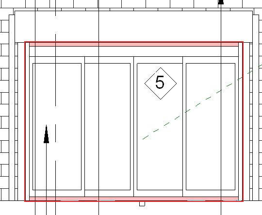

I've taken a storefront wall door family and modified it.
The end result has a couple errors, but let's stick with one for now:
The door/panel does not override the lower framing members the way the original did (highlighted in red on the attached images) and I'd like it to override both top and bottom.
Any input/suggestions are appreciated!
I'm in R '09.
Edited on: Wed, Jul 16, 2008 at 11:07:08 AM
Wed, Jul 16, 2008 at 1:49:58 PM | Storefront Wall - Door Family issues
Delete the bottom and top mullions....
