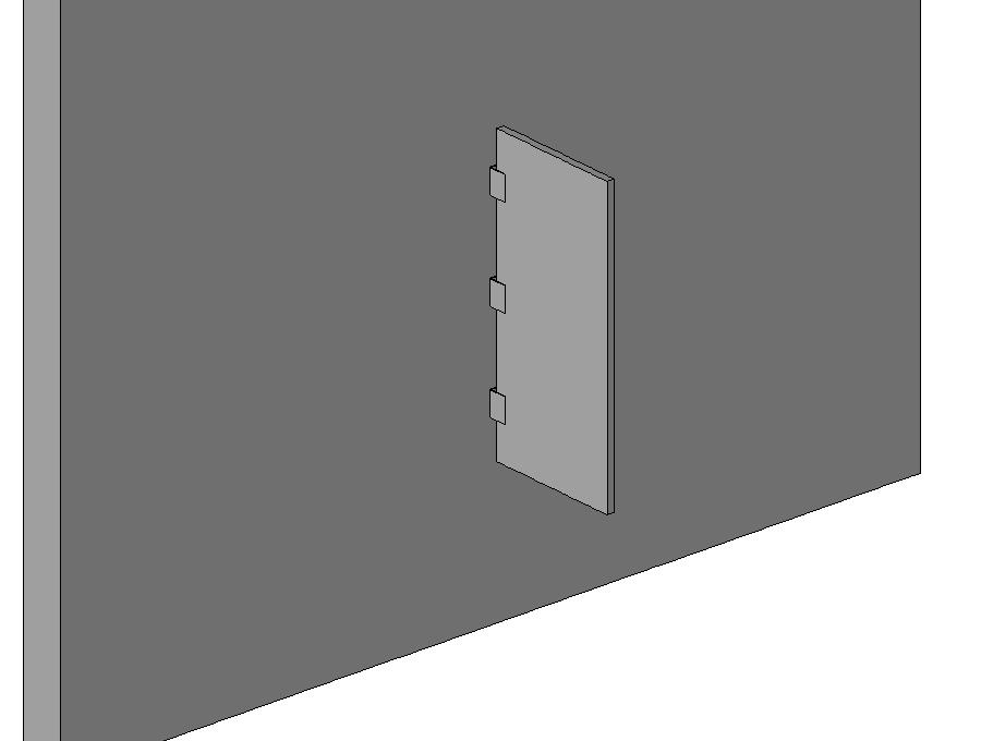

Well I created this Urinal Partition and would like to show it from the side since it really does nothing for me to show it from the front or in plan.

Use an elevation of an in-place unit and hide the view mark in the plan....
or re-build your family and change what is the front....  could maybe just rotate everything in the family.
... out of the box thinking.... insert this family in a new family where the front is rotated..... only use this new family for your legend.
