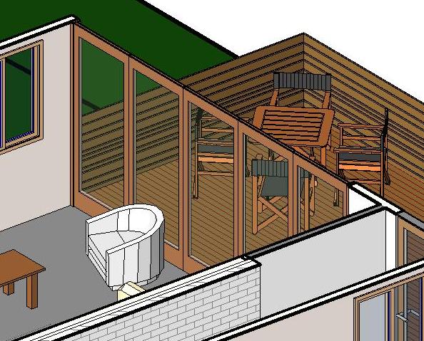

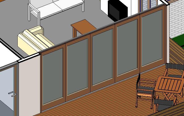

Having a weird issue with the visibility of glass panels in a bi-fold door in Revit Architecture 2008.  The glass appears transparent from one side only (see pics). In 3D perspectives it always appears opaque. I've  tried a million changes to the materials etc. to no avail. Could it perhaps be an issue with the wall-hosting?  This has got me really stuck - any suggestions would be greatly appreciated! Cheers. Pete

I found the problem with your door and attached a "fixed version".  The problem was with the "opening cut" for the wall. If you pick on the cut opening two toggle-boxes will appear that you can check for "visible in 3D" and "visible in elevation". Neither box was checked in your version.

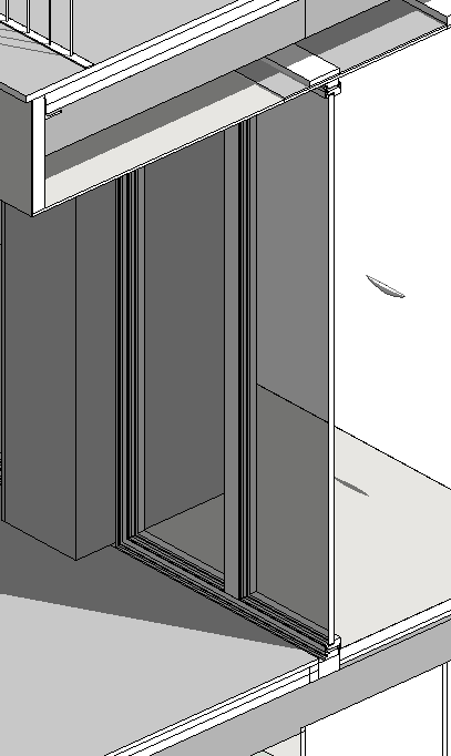

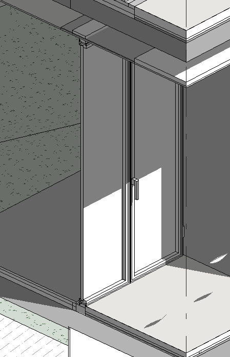

I have kind of the same problem because the solution presented didn't work. The "opening cut" is set for "visible in 3D" and "visible in elevation".
Any ideias?
I atached the family so anyone can check.
