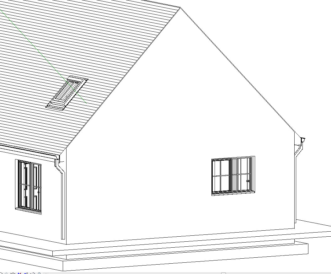

hi all,
i'm a new user of revit and getting on great with it, but have run into a problem, in autocad architecture i was able to create a flush gable end easly by abstracting  a mass from the roof and alining the walls to the roof. can this be done in revit & how this could be achieved. i have a photo to what i mean many thanks and a great web site.
phillip
using revit architecture 2009

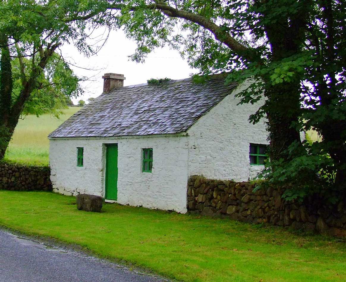

got video to work, if you look at picture in first post, you will see how the walls and the slate roof meet at the gable, no facia visible,

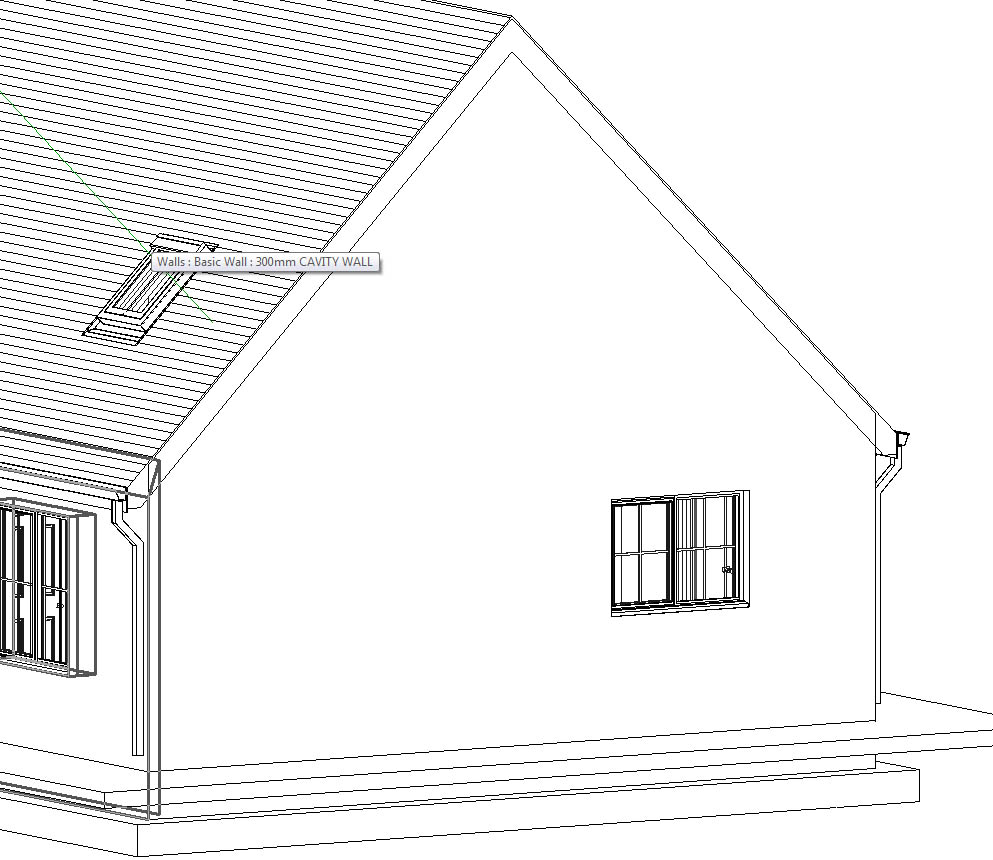

thanks again for fast reply, i think i solved it check out gable 1 & 2, i sketched the wall to below slate roof, and hide bottom line.
