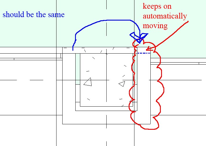

I had this wall cladding that Id like to align along the face of the column. Every time I try to move it, it always move automatically and trim with the Insulated wall I place to cover the column. How do I control the wall from automatically moving and joing the other wall.
Revit 2008.

I don't know if this helps but try - select wall right clck over wall end and select disallow join from menu then use your 'move' command and check the disjoin box before moving the wall.

Im lucky, lucky dug.
It work. Thanks.
