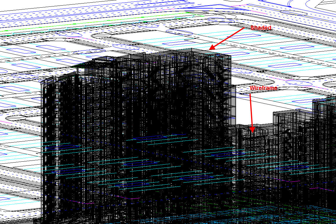

I have a Revit model done in Revit 2009. Somehow when in 3D view (not camera view), the model shows up as half shaded and hlaf wireframe. Why is it so? The viewing is set to shaded with edge.

its just a bug. delete the view then click on the 3d button to bring back the default 3d view should fix it. its happened to me a few times. can't remember if its happened since i installed the service pack but if you haveent installed it then you should.

Tnaks KingRevit. It works as you said. I think the service pack does not help as we have tested it.

Recreating worked like a charm.
