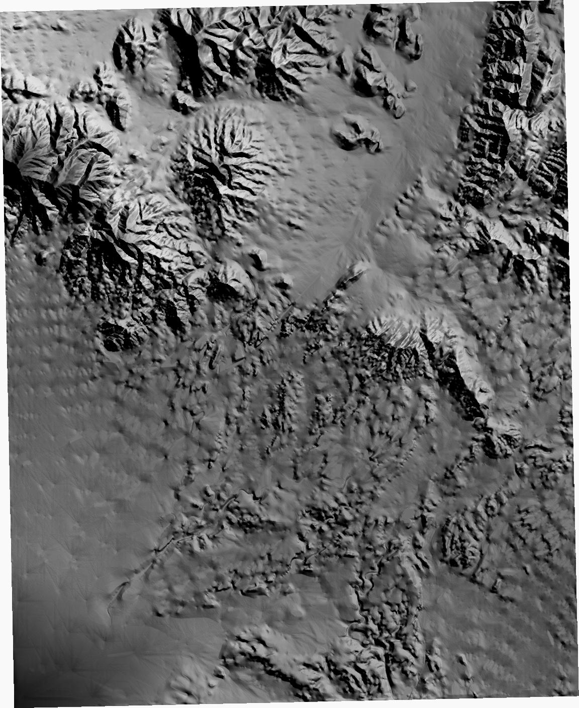

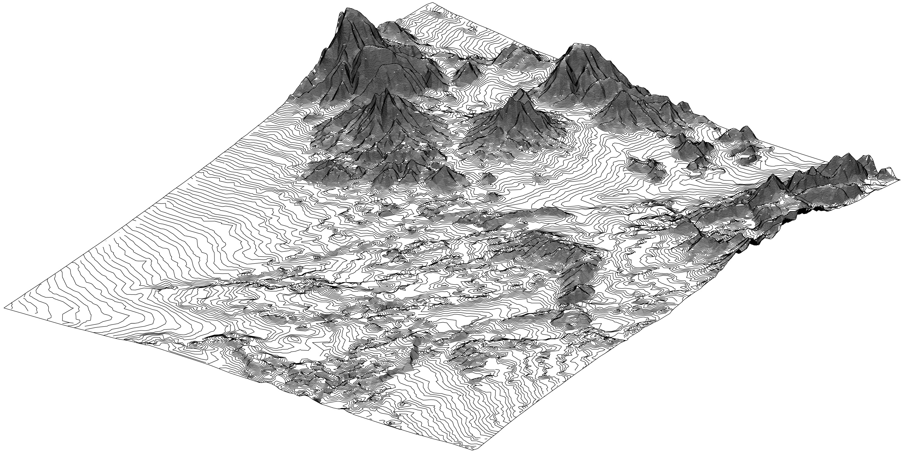

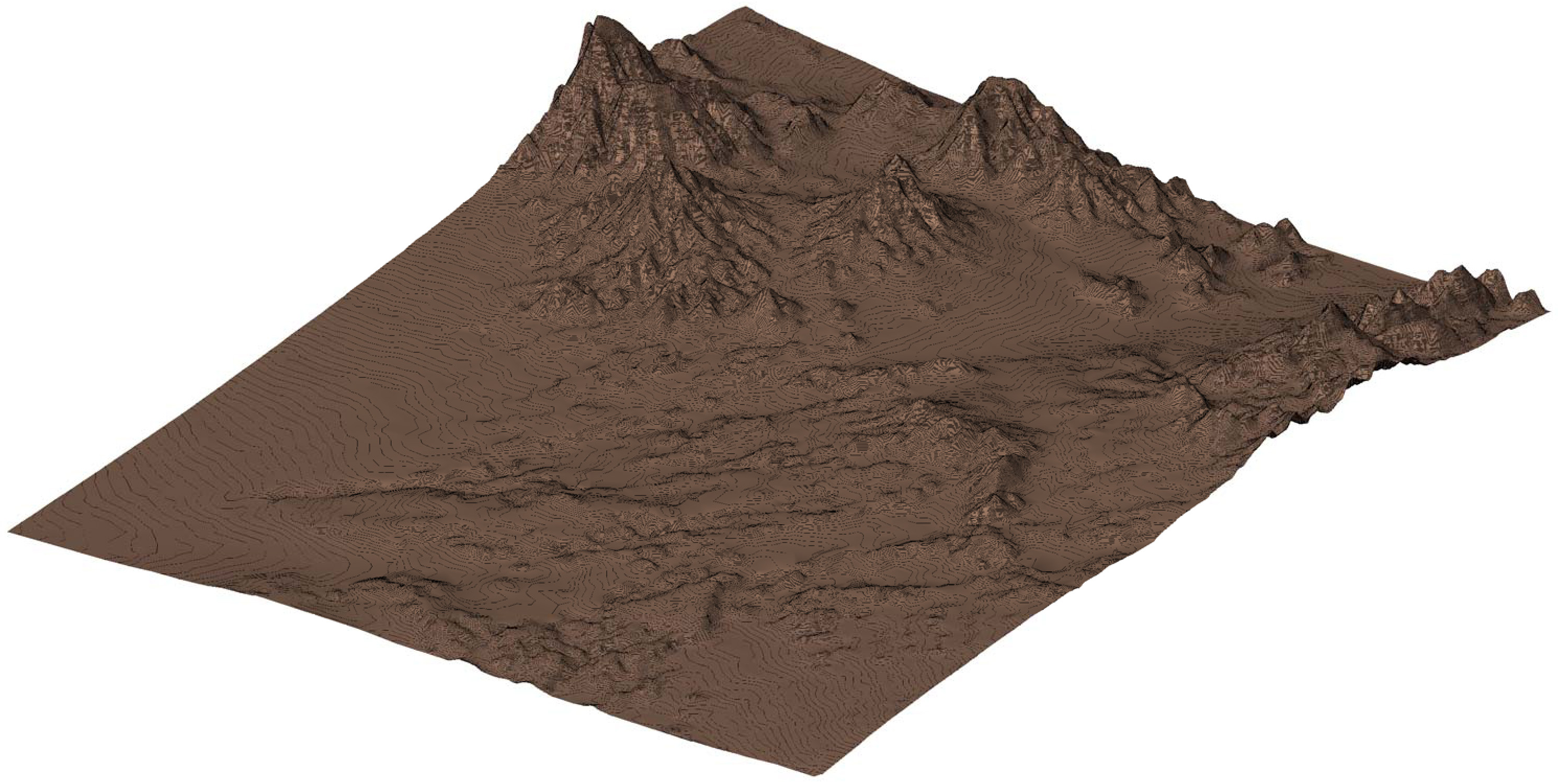

Ok here are 4 pics, of the Quad NV-APEX, I got this from them when I got the entire Las Vegas NV valley.  Bear in mind that I specialize in presentations.  Having an accurate background of the surrounding area had become critical if I was to compete.  The NV Apex.jpg is the top down view of the Quad shaded.  The NV Apex3dhid.jpg is a 3D view in Revit Arch in hidden line mode. The NV Apex3dshade.jpg is the same view in Revit Arch with Shade mode.  The NV ApexPlan is a site plan view of the contours.  The primary reason that I am showing this Quad is it is the one that I started with awhile back I took it from DEM to revit in about half a day and the file size in Revit was 120MB in 3D Max direct from DEM took 1.5 hour processing time and the file size was 99MB with only the terrain in.  This file that I got from them is 16.6MB and is a toposurface which means (this is what I really like) I can seperate surfaces or subregion it for shade colors and render texturing with different material or colors.  Also the pad command and grade region command work just fine for tweaking an area just the way I like it.  As to cost, I am a one man shop and definitely on a budget but I have found that time is money.  The cost of producing them on my own was at least 3 times the cost of each Quad.  I joined XYZ Resources for a month and got a $20 per Quad discount for $10 and I bought multiple Quads.

Man, Thanks a lot for posting those images...pretty sweet.  So from your standpoint of view, is it worth doing this if the site is relatively flat?  Also, this doesn't help if all you would see is buildings in the background, correct?...particularly on a flat site...what are you thoughts on this?

I will some times add in some very generic boxy buildings if it is necessary.  But the usual focus is on the project being modeled or presented.  The views with the landscaping in place with the hills or mountains on the sky line in the correct proportion makes the image more presentable.  I ususally have the landscaping prevalent in the imediate horizon and the mountains in the background but in the right proportions and the right location.  The horizon here in Las Vegas is very distinctive and there are almost always some montains in your far horizon.  Working great for me.  I have kept the toposurfaces in quad form and xref them in so that I only have in model what I need for the view.
