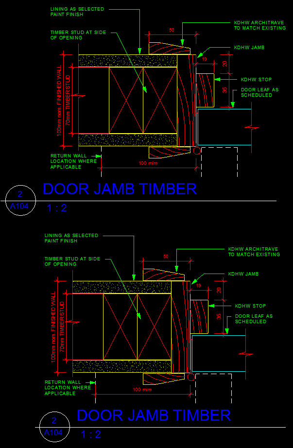

I have been setting up our office details and found that the viewport title position related to the actual detail is abit off when I dump the detail onto a sheet.  See attached image  The top detail in this image is an example of this  Is there a way to alter the position of the viewport title so its more inline with the detail - see bottom detail.
Hope there is a somple solution.
I originally though that the detail (drafting view) had a bounding box that would determine the placement of the viewport title but this is not the case as the circular section of the tile is always to the left of the detail - why????

Sorry, I figured it out.
I cut an paste the title I was using into a template file to see the placement of it.  It seems that the bubble was to the left of the insertion point.
