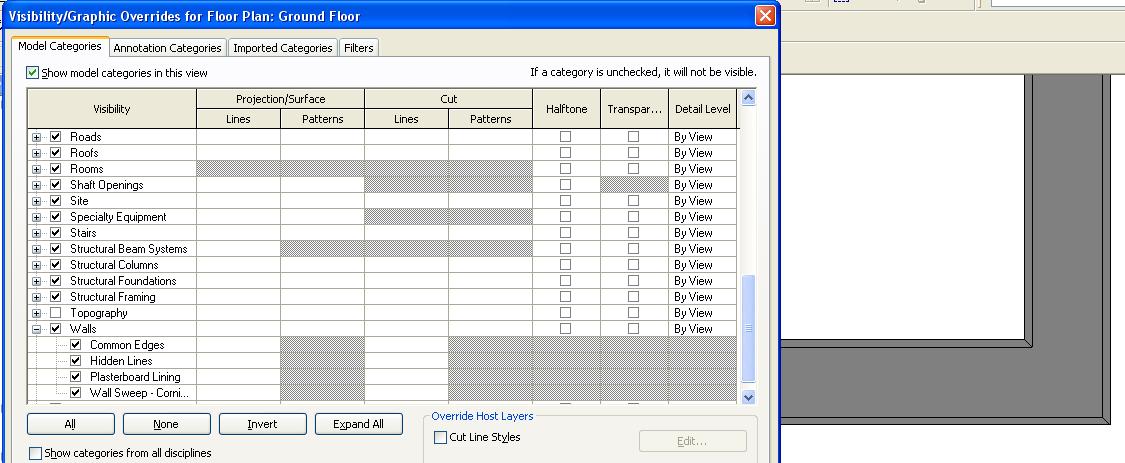

Gday, using RAC2009
Lets say i have a wall comprising of 75mm CSR powerpanel, 25mm air cavity, a 90mm stud and 10mm plasterboard. Is there a way to hide just the 10mm plasterboard? I need just the CSR, cavity and stud to show up in floor plans, but in sections and things that cut my wall, I need to show the plasterboard. Everytime I go to a section view I have to draw a line representing the plasterboard, and it would be alot easier if i could just hide the plasterboard in floor plans. Any suggestions would be appreciated =)

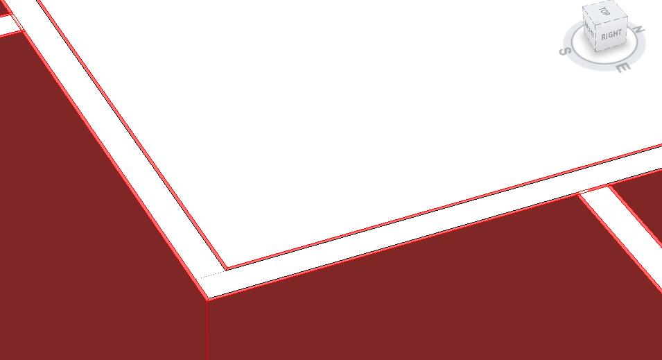

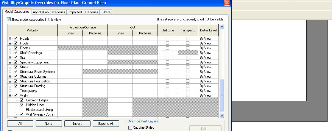

There is a quick work-around I have been trialling. I created a new profile family with parameters wall thinkness, lining thickness and height and created a new sweep using my family. I put this sweep into the subcategory of "Plasterboard Lining" in Walls, so whenever I need to turn off the plasterboard I adjust the Visibility/Graphics settings. Could people please try out this method and see if it works for them?
