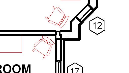

so i have searched and read about everything here i can find and tried about them all. I am still having issues with my stacked walls. No one in our office can figure it out. Basically i have brick on the lower, siding above. they are not joining nice and cleanly at corners and interestions with themselves. Also where they interest with other wall types it too is a mess!  And finally, I have areas where i have 3 walls types combining (stacks, full brick, and interior) and this is a mess. I have countless wasted hours on this....does anyone have any suggestions for solving these issues?
I am using 2009 btw.

are your functions of all your walls the same for the same material?
ex. structure1, finish4 and so on,
the same for wraps checked on or off?

you will have to post images of your mess as it could be a few dirrerent things.

ok, here is an example of the main problem.
to answer the questions, all materials are at the same functions, and all walls have wraps off.
