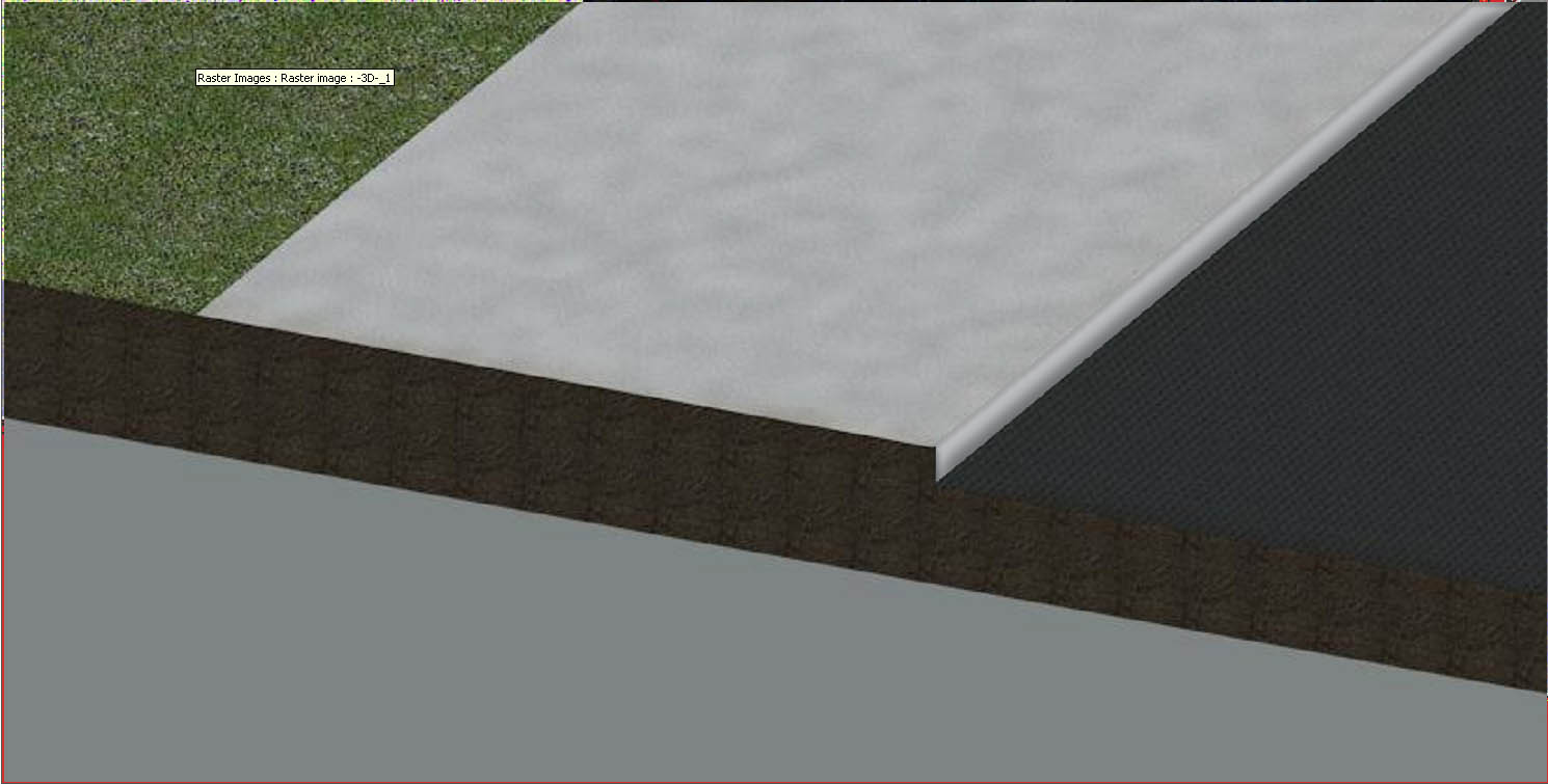

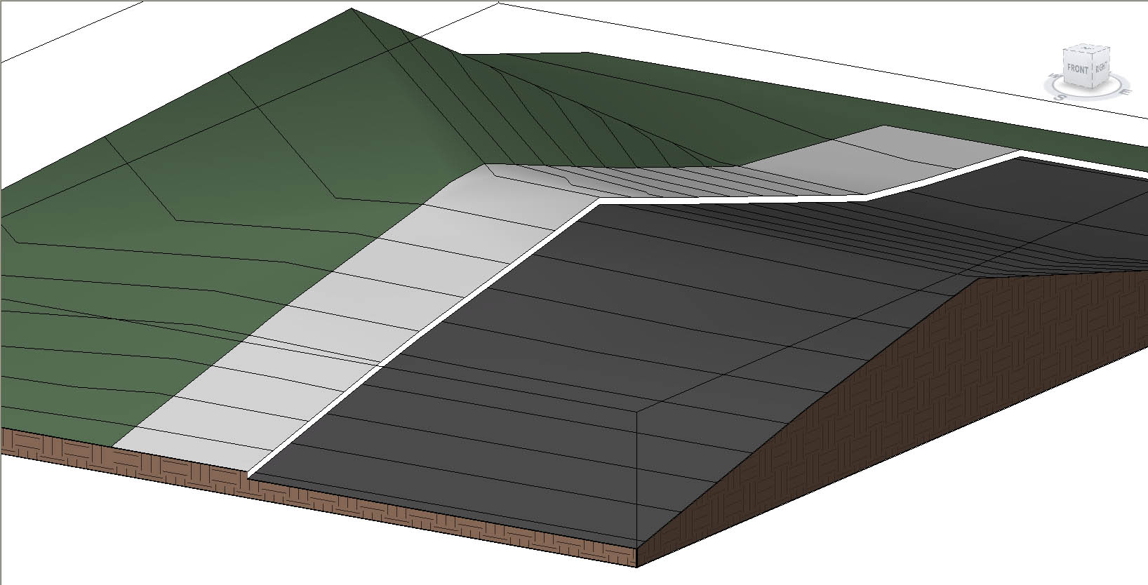

Revit 9.0 This solution is for rendered images only.
Create the topography first.
Then make the streets a subregion offsetting the elevation to whatever you want.
Create the sidewalks splitting the topography.
Render the image.
Make the curb in photoshop.
