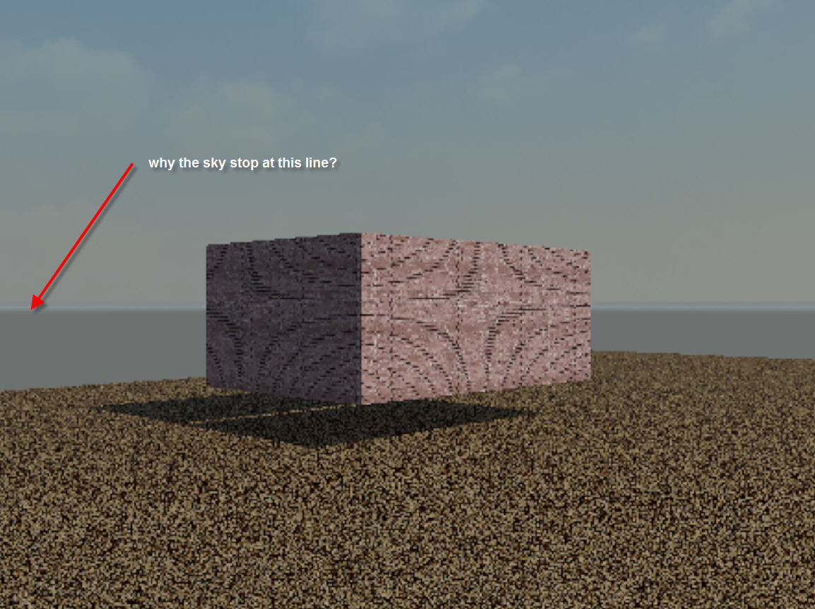

I wonder has anyone faced the same problem when they render the sky in Revit 2009? Since Revit 2009 does not allow you to place a background image, I am finding it diffcult to do a good sky for my rendering. Furthermore, my sky rendering stops at certain level (as attached). Wonder how to make the sky goes all the way down just as in Revit 2008?

The sky in RA2009 is using Mental Ray to produce a physical sun and sky dependant on time, date and location.  As the color under the horizon is greyish you should be able to render out as a tiff,  then take your image into Photoshop where you'll notice an alpha channel so you can replace the sky with any texture.
When I was using Maya whilst rendering with MR we had the same issues. The workaround we created was a background dome within the scene that didn’t block or cast any Global Illumination or Final Gather of the sun and Sky - purely for the look and shadows etc.

or you could bake your ground surface larger.  With modifying your camera angle you should be able to reduce this effect.
or
Photoshop your ground surface to meet the horizon.

turn off the sky and use a solid colour say white. then use a decal for you sky, just make a large wall and import a decal onto it.

The line represents the horizon - the sky doesn't come below this.  Export your image as a tiff and reinsert it in revit and put your background sky behind it in a drafting or sheet view.
