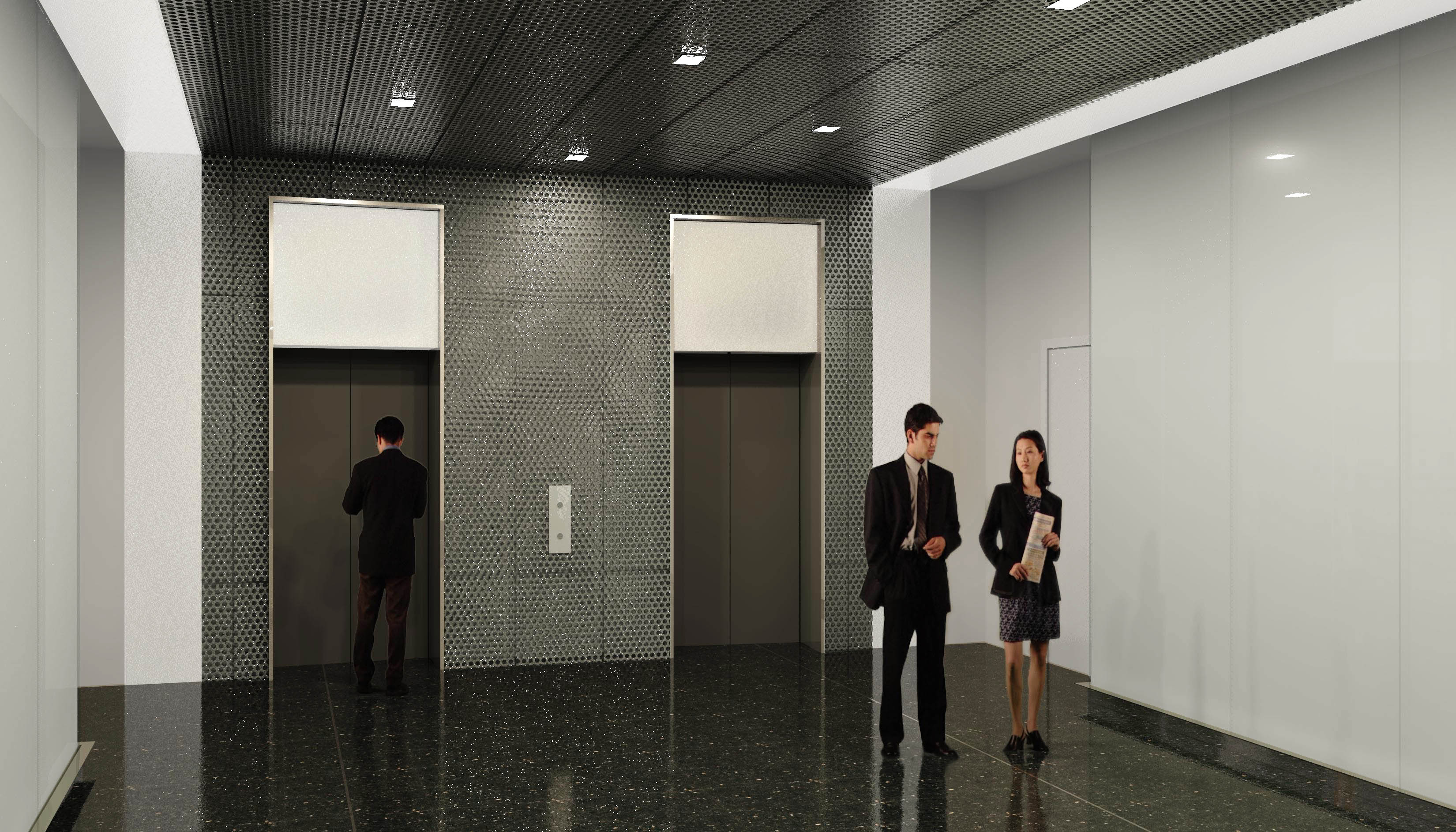

ok thanks, i'll keep testing, i was talking 2009 to 2009 new build but i cant see any changes in the renders yet, i'm having trouble with internal daytime renders, i have to keep using artifical lights everywhere to get global illumination in the rooms as in the lobby view enclosed there should be sun comming from the base shining through the entrance doors but its not working for me.

they have made changes to the Render Library in the new build of RAC 2009 and Autodesk recommends re-installing all librarys with the new build.
