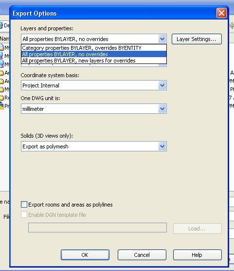

All my text notes, leader lines and arrows are not exporting to ByLayer.  The text is White, leader lines Green and arrows are Yellow.  This means each time I export to Autocadd, I have to clean up the text to ByLayer.  Everything else works just fine.
 I'm stumped.

Did you select the right options? What version of Revit are you using? I did it just then and it worked fine for me.

hi this is something that i would suggest you spend some time on and set up a custom export, as you get strange results with the default like the notes on stairs do not go to your text layer ect. once you get it right it works really well we have ours set up to our cad standards and use colours foe lineweights in cad so when i export a view all i have to do is place it in a layout and then it prints just like one of our cad drawings.

Thanks for all the feedback.  Bylayer no overrides worked.   Much appreciated.
BTW I am on Building Arch 2008 and I have created custom export and this was the last problem.  Hoping for the day we don't have to export to Autocadd.
