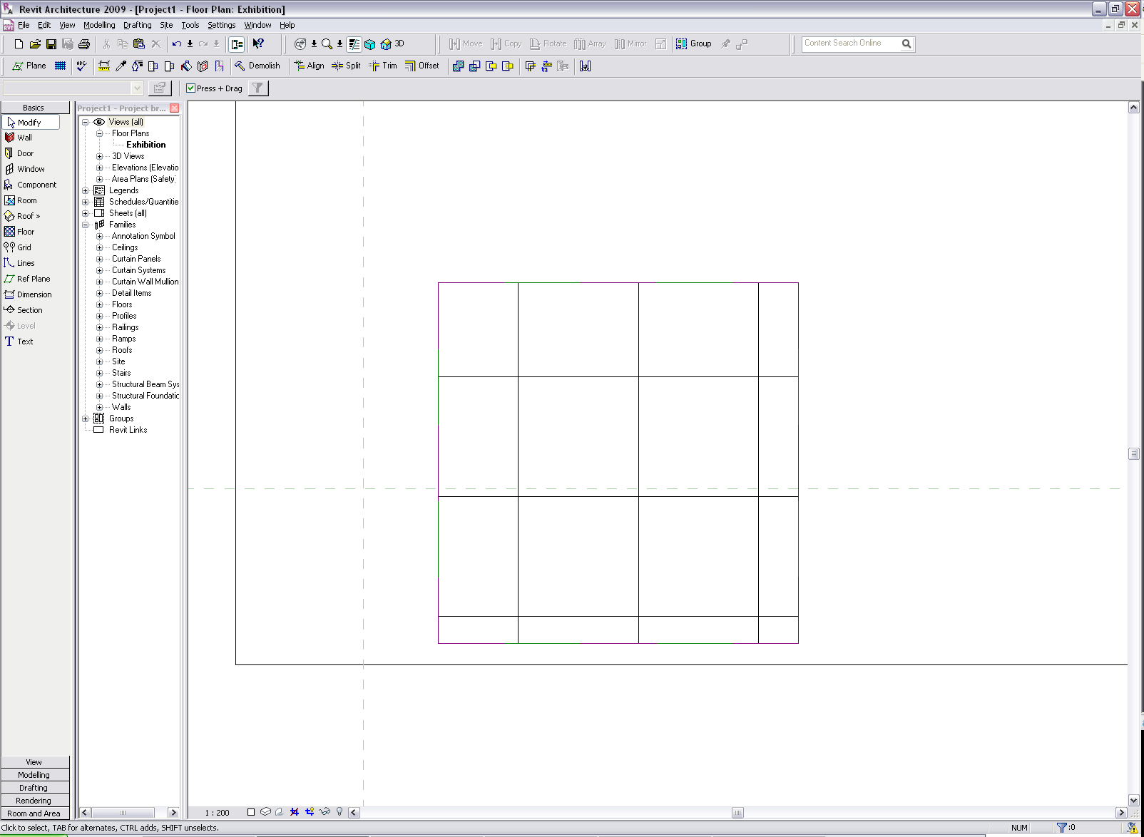

I am trying to align a simple crosshatch fill pattern to the surrounding room boundaries, this was a simple task in Revit 2008 - simply selecting Align > Room Boundary > Crosshatch lineHowever I seem to be struggling to do the same in Revit 2009 - has this feature been removed? It will not let me select any element within the fill pattern.Any ideas?Anyone seen this before?i've attached a small demo image.
thanks,Simon.

Never mind...
Revit 2009 had upgraded my 2008 floor type and changed the surface pattern from a Model Pattern to a Drafting Pattern.
My head hurts...
thanks,Simon.
