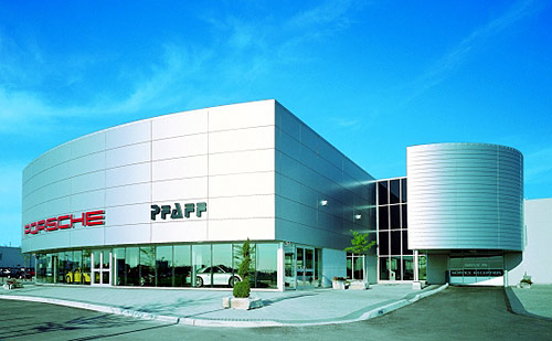

hi. can someone please help me create a new material?
i am trying to create an 'Alucobond' material with a grid of 900x1200 with a metalic finish. (see attatched image for an example)
any sugestions welcome. thanks.

Try using a curtain wall as this will deal with your grid.  Instead of glass make your panels alucobond
In regards to the material, try using a glossy metal. Trial and error

Create a drafting view and draw the desired panel. Export it as an image, and when creating a new material, assign this image as a bump pattern. To get the colour, zoom in really close to the metallic colour and take a snippet of it as an image, and when specifying the colour, use the snippet image. This only works for Revit 2009. What version are you using?

Draw an alpha image of the grid and aissgn it was your bump image
so jump into photoshop/GIMP etcand draw your 900x1200 grid and then assign that image as your bumpafter that google aulcobond and find a suitable picture for your material imagethat should do itbut i feel cutrain walling is better suited, and easier
