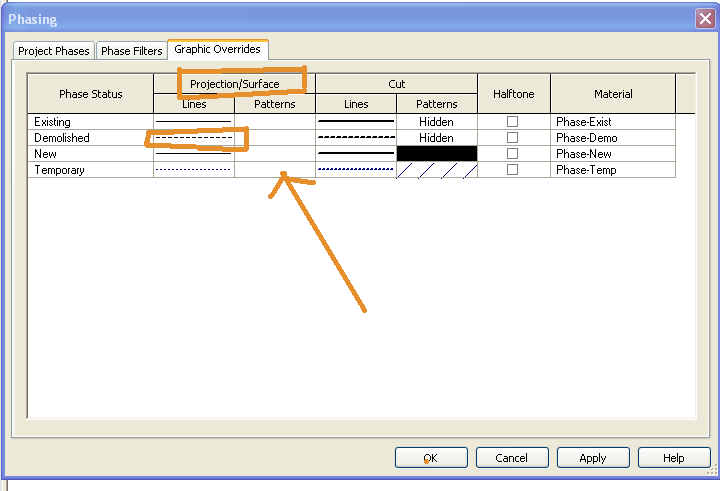

I have a 2 x 2 ACT ceiling grid that is using a simple model lines pattern as a surface pattern. When I demo a ceiling of this type, the model line pattern does not become dashed, only the boundary! Does anyone have any suggestion on what I might do to get the ceiling grid lines to go dashed once demolished?

Has anyone ever replied to your issue or have you figured it out?  I am having the same problem and cannot for the life of me figure it out.  Any help would be appreciated, thanks
Thu, Dec 15, 2011 at 3:16:22 PM | Demoed ceiling grid won't DASH!
I set up my phase filter - graphic over-rides to show existing ceiling patterns as dashed.  Here is the problem.  Thy print dashed but not on the screen.  Check it out.

Where to you find existing ceiling patterns at the graphic over-rides?
Thu, Dec 15, 2011 at 3:54:56 PM | Demoed ceiling grid won't DASH!
Here

Ok i spent the better part of an hour trying to get the visibilty to be dashed for my grid lines. They appeared solid on my screen so i thouhgt they were solid. i had everything set up correctly and like you said once you print them they are dashed. ugg, i have been using revit a long time, and defend it it to everybody in the office. this one ticked me off. hub thanks for the advice.
