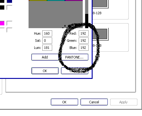

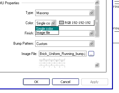

Hey, you can easily create your own. Go to settings-->materials and duplicate any material you want. I usually click the replace button and make it a generic material. You can specifiy the RGB properties of a colour, or use the pantone library. As for the FBX file, I dont know what they are.
