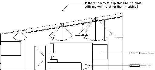

Is there a way to align a clipping line? Pls, see attached. Thanks

Nope.  This situation is the reason masking regions are included in the program.  Is there a reason that a masking region will not work?
Also, just to clarfiy: you're making sure that masking regions, not filled regions are the alternative to this, correct?
