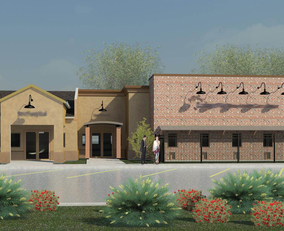

Brian, I created a brick wall that had two rows of a soldier course.  I added two "profiles" of my soldier course rows in the wall edit screen.  When you add a profile, you can assign an image to specifically that profile.  In photoshop, I made a soldier course brick image and assigned it to the profile.  The result is attached.  If this is what you are talking about, it's a fairly easy solution.
