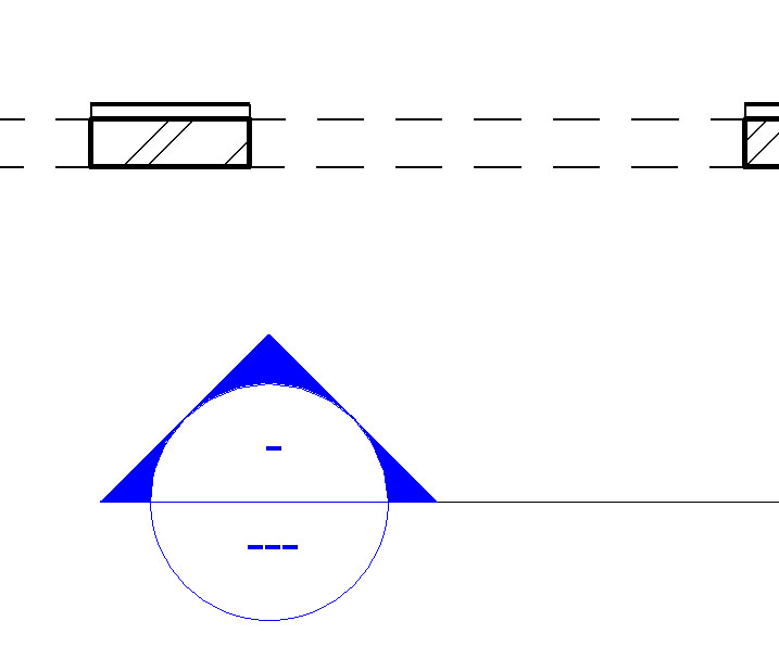

I have encountered a problem while using sweep for a wall.  The sweep does not wrap around the wall incase of an opening in the wall.  The attached image will tell you the situation i am in.  while using external walls in corridors or balconies, if I have a sweep around the wall base, it only cuts off wherever there is an opening or an insert.  Unlike the compound walls that wrap material around the inserts, sweep does not wrap around.  I tried using the primitive revit method of using a thin wall to make a box  around the main wall so that the sweep wraps around.  But in actual construction drawings, I would look like a fool if I did that.  Please help me with this.  Thanks.

If it is a wall sweep select the wall sweep then select change sweep returns make sure that the angle is specified at 90 degrees then select the end you want returned.
