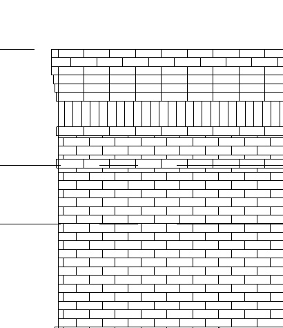

I have a corbelled brick cornice made from sweeping profiles in the Assembly Editor.
Is there any way I can edit the hatch so that the swept profiles show as a running bond pattern rather than the stacked bond I'm getting by default?  (See attached pic)

Have you tried splitting face and paint bucket?

Turns out to be MUCH easier than that.
You can select a line of the hatch (elevation view, tab through to get the right thing highlighted).
Then just move it.
Wah-lah!
Thanks for the suggestion though!

you can also use the align tool
