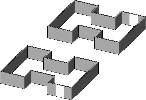

I am using Revit 2009. I have a two bldg project. They are basically a mirror of each other. On the west wall of the west bldg I needed to use split region to create a area with a different color on the wall. I have to make the same area on the east wall of the east bldg. I go to the east elevation and select the wall for the split region and it gives me the west wall of the west bldg and it won't let me create the region. I tried using a slightly smaller region and that doesn't work. I tried selecting the wall first then the command but you have to reselect the wall and I get the west wall again. Any fix on this?Same poject, I want to render a 3D view then move it over to a 24x36 sheet. I move it over to the sheet and it is very small. I go back to the rendering and change the scale to 1:1 and it is still too small. I use the custom feature and try to go 1:-2 and that doesn't work and box comes up that says I must put in an integer. What can I do to make it bigger?

Sincerelly i don't understand what's the problem in split the walls.... the error "I must put in an integer" it's because you put the sign "-"
join wall with split region with wall without split region
