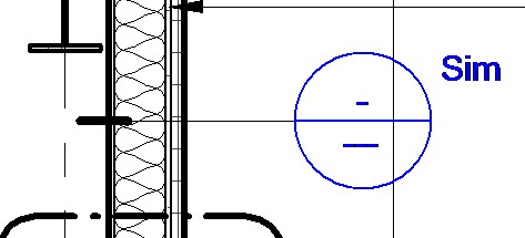

Just use a callout, detail that refers to what you want.  Very...very....very small bubble - see attached.

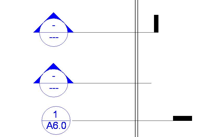

I'm not sure if I'm following you. Here's a picture of what I'm referring to.

You can create a section from within the section.  I tend to avoid using detail sections in most cases because they have some strange built in visibility limitations.  You must run it vertical first, then rotate it 90°.

As I said, use a callout detail.  This is a section with a callout detail.  The blob at the end of this callout is really the callout bubble.
Tue, Aug 5, 2008 at 5:03:35 PM | plan detail callout in section
Katwoman
Joined: Wed, May 16, 2007
8 Posts
Thanks that did it. I was having difficulty changing the family category initially. Cheers. kats
