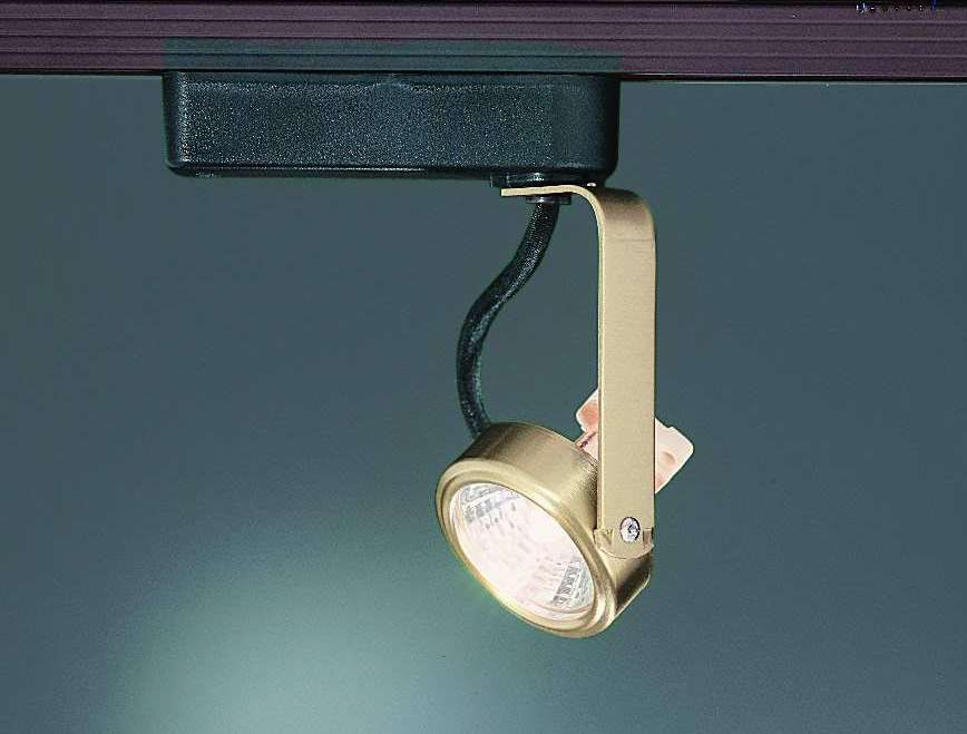

hey guys; I need to make some custom light fixtures (small halo lamps) I thought I will modify existing spot light (see attached) but I dont know how they made that adjustable light sorce w lumens wattage etc.??? do you? also how do you make an object parametric---spin??? Thanks, luke

i am talking about some phisical object that is placed in my fixture frame that represents light source?? when I open existing spot light there is only frame itself but no point source? do you know what I mean?

I do not know what family you are modifying so I do not know if you have what you need.   For spot source lights, you will have two reference planes in plan and elevation.  If you touch these, you will see that they are labeled as source axis.  The junction of these planes is the location of your light source and obviously, you want that inside your lamp.
For linear lights, you will see the same except you will have an invisible line that is the light source.
Note that you must have either no lens or a lens that has some transparency in order for your light to work.  The inside back of your lamp should also have a reflective surface.
Now, if you have this mdeled correctly, set the lumens under type according to Typhoon's post.

wwhub... all I want to do is convert that 'brick like' standard spot light [please see my first post w/ pdf @ the top] to something like I have attached to this post...
