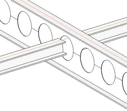

I've just used cellular bemans for the first time. It appears to work well except I'd like to remove individual holes from the beam where a secondary beam jins it at right angles.
Is this possible?

As you can see the smaller connecting beam has nothing to connect to as it's in the position of the hole.
I'd like to remove just that hole (& others in a similar position)
Hope that clarifies.

Hi, the beam it's a family and just like you could see have many parameters to control that beam, that it a parameter you can control to solve the problem, i don't know if you figure out yet but you can "move" the holes to the left or right position and in this case it solve your problem, i put you a Video with this: http://screencast.com/t/ovBeKJD7h
But if this is not what do you wnat you also can edit that family and change them, but if you are not at ease in working with families i think the best is "create in place" one of this beams and change the hole position how do you want and like...

Thanks for the video - very useful.
If I move the holes to miss one beam it hits another, but we're looking into how put them at the correct centres to avoid all.
