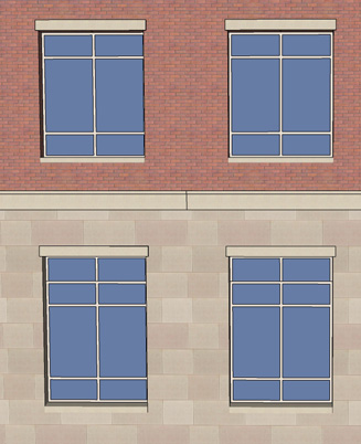

I'm getting hung up on moving mullions on storefront.
I'm trying to make punched storefront windows like in the attached image (using 2009)
Using layout parameters (Maximum, Minimum, Fixed #, Fixed Dist.) seem to work for even spacing only.  Is that assumption right?  Layout: None leads any type-driven mullions to be non associated.
Here's my thoughts:
Even spacing is fine for the 1 vert mullion (Fixed Number, justified: Center).  So that can be type driven.
The horiz. grids are not evenly spaced, so I assume I just have to draw them in.  I used the Curtain Grid.
Cool.  They're drawn in, but need to tweak the horiz. spacing/distances.  I can't seem to do it either graphically and can't find a parameter to change the distance.
Is there a better approach?  How do I move mullions?  Please help!

Had this answered by someone elsewhere...
Mullions can be moved by selecting their grid lines.  Grid lines can be selected by pressing TAB while mousing over the mullions (will show up as a dashed line centered on the mullions).  When you select the grid line, temporary dimensions show up and you can key in the new value.
Sounds so easy, it's just not intuitive for the first go.
