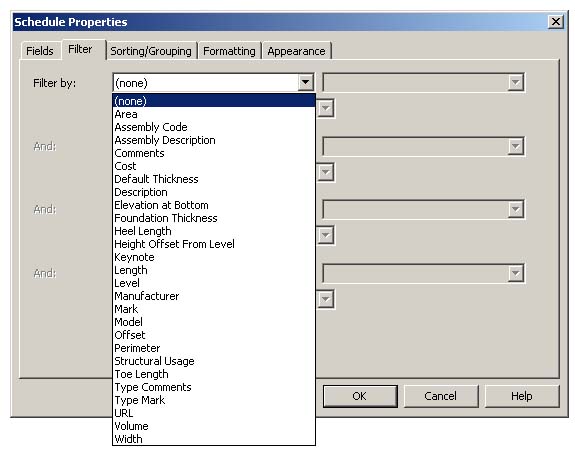

Users ask on how to eliminate certain objects from the schedule, and the ready answer is: THE MAGICAL FILTER COMMAND.
Well the FILTER command does not filter TYPE or FAMILY:TYPE which seems to be a major flaw in the program. What I suggest you do is either create a new shared parameter, or use one of the existing parameters that are not being used (such as COMMENTS) and custom the filter accordingly......
