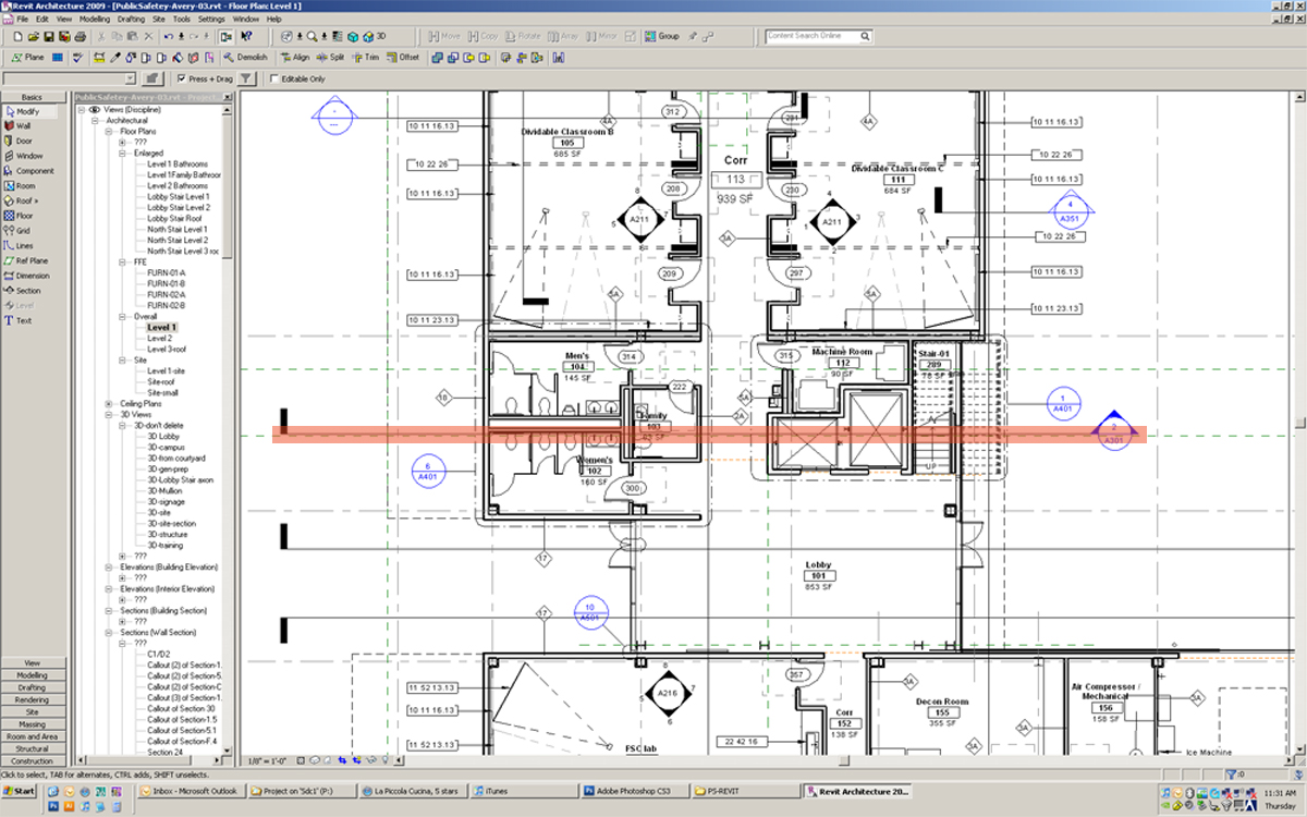

I have a building section (1/8 scale) that has a floor plan (also 1/Shadey as its parent view.

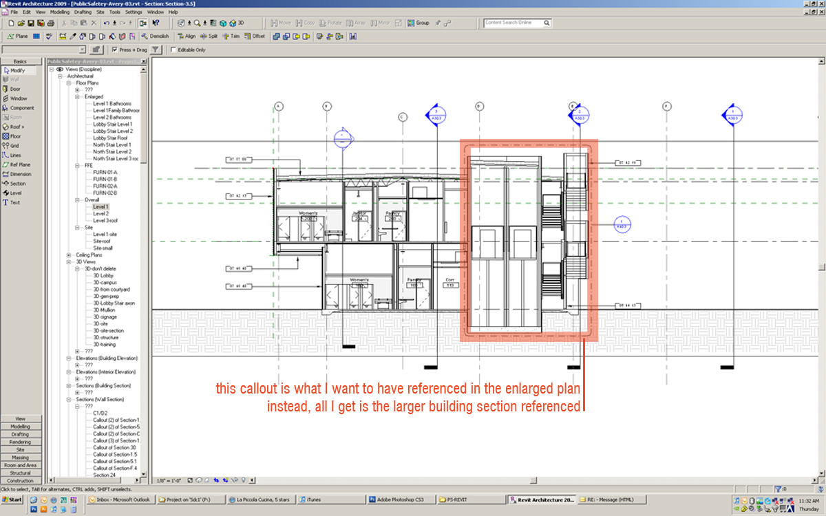

In the building section, I have a callout (wall section type, at 1/2 scale) of a stair.

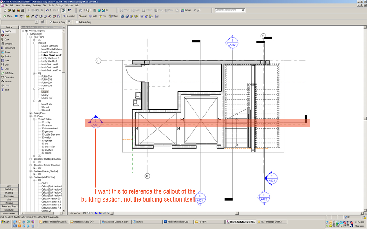

I have an enlarged plan (1/4 scale, with the 1/8 scale floor plan as parent) of the stair that the building section (1/8 scale) passes through.
The building section shows up in the enlarged plan (1/4 scale). However, I want to have the callout (1/2 scale) display in the enlarged plan
instead of the building section.
Basically I want the callouts on all of these views to reference views of finer scale, not coarser. Hence the 1/4 scale enlarged plan should show the
section callout of 1/2 scale, not the building section which is at 1/8 scale.  I know I could manually turn off the visibilty of the building section, and then create a new section that references section callout instead. It seems there should be a better way to this and wondered if anyone had any solutions.

Thanks for the reply. I'm not sure if I follow what you're advising though. The terminology here is somewhat of a hindrance so I've attached some screen shots of what I mean.
I trying to find a way around drawing a new section cut through my enlarged plan. I defined the view while I was in the building section weeks before I had created the enlarged plan. Now that I have the enlarged plan, I could redraw a section just north of the building section in the enlarged plan, and then copy over all of the line work and annotation from the section callout I had previously created, along with any detail callouts placed in the view. Then turn off the visibilty of the building section in the enlarged plan, and make sure I have the visibilty settings for the newly created section correct to make sure it gets referenced in the building section.

I'm aware of the rules that dictate which call-outs and sections are visable in newly created views. What you describe is the default where Revit hides callouts and sections created on a view with a finer scale than the view in question. This can be over-ridden in the callout or section properties by adjusting the "hide at scales coarser than" instance parameter to something other than the default value.
As for transferring 2D work, I've used the method you describe but I try to avoid it as things like keynotes, which are tied to elements, sometimes have difficulty copying.
To solve my problem what I had to do was change the properties of the "child" callout to have no parent (in essence orphaning it). After doing this both the building section and the orphaned callout of the building section showed up overlaid on each other in the enlarged plan. Then I manually turned off the building section in that view.
