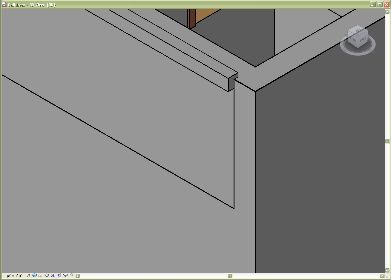

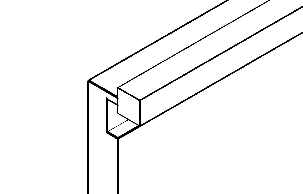

The two pictures show what I was trying to do:"Sweep-highlighted.gif" shows the sweep highlighted, you can see there's a 2" thickness which I wanted to cut inside the wall."Sweep1.jpg"  shows the sweep applied to the wall, but the wall was not cut.
Thanks again!

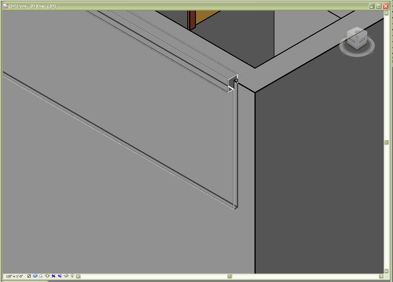

I see what you mean. The attached image has a top wall sweep and the recess is a wall reveal.
