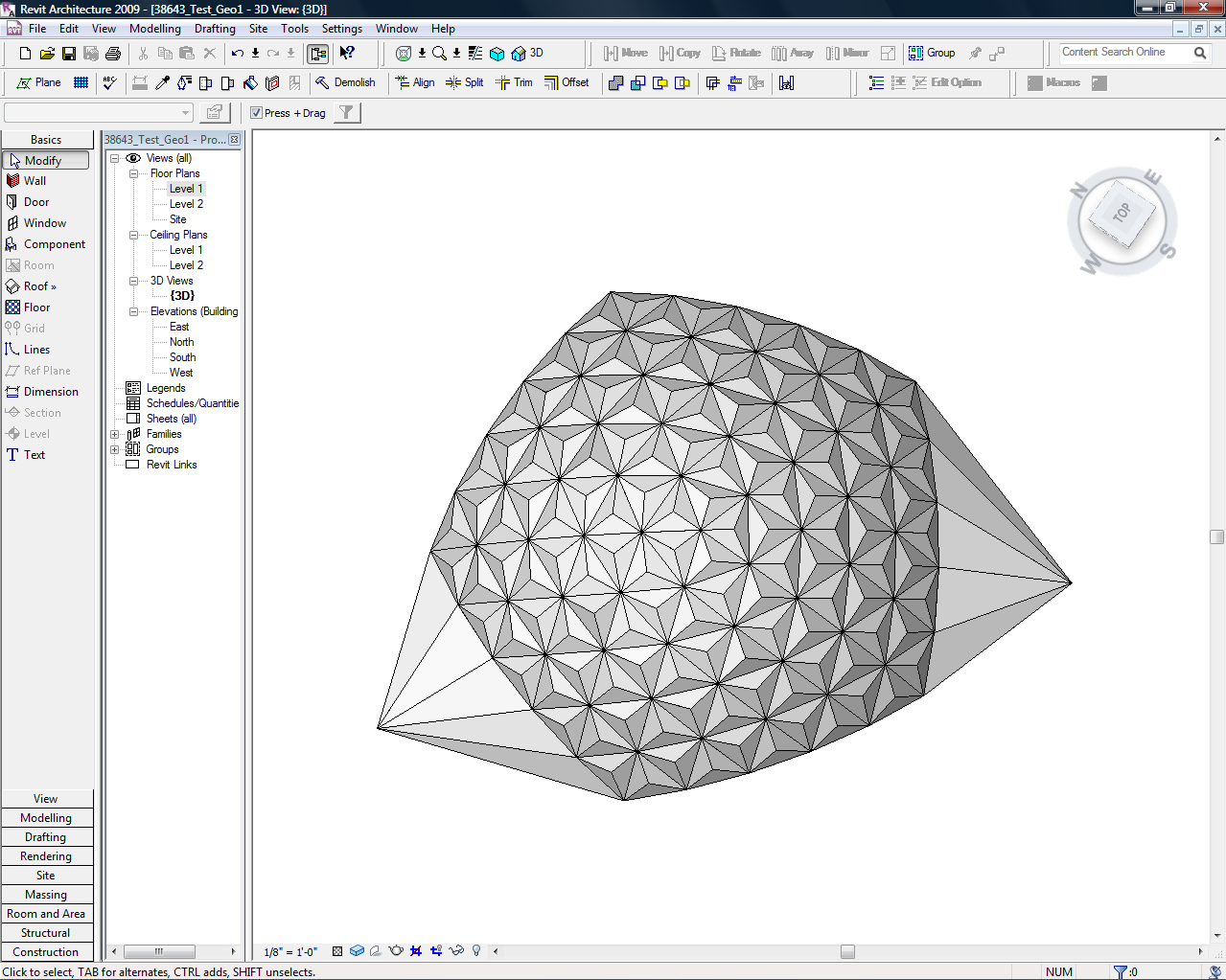

I am constructing a geodesic dome. I only had to model 1/5th of it. I created a square roof that I could add bearing heights and then cut out with vertical opening. I completed the construction of the 1/5.  I grouped the opening cut and the roof. No matter what I try. example: I can mirror 4 of the 5 panels just fine but when it comes to the last 5th it tells me "CAN'T MAKE CUTOUT".

Can you put some images here to figure the model?...

Here you go!  Have Fun!

Hi, you can do ti with "Array - Polar"

I did that and it tells me the same thing. Can't cut out....  It's only that one piece.. Did it work for you?

Yeah, there is some issues but...

I exported 1 segment to DWG, then imported it back into revit in a Mass Family then did the polar array...

I actually ended up offsetting the cutline by 1/16. I worked perfectly...
