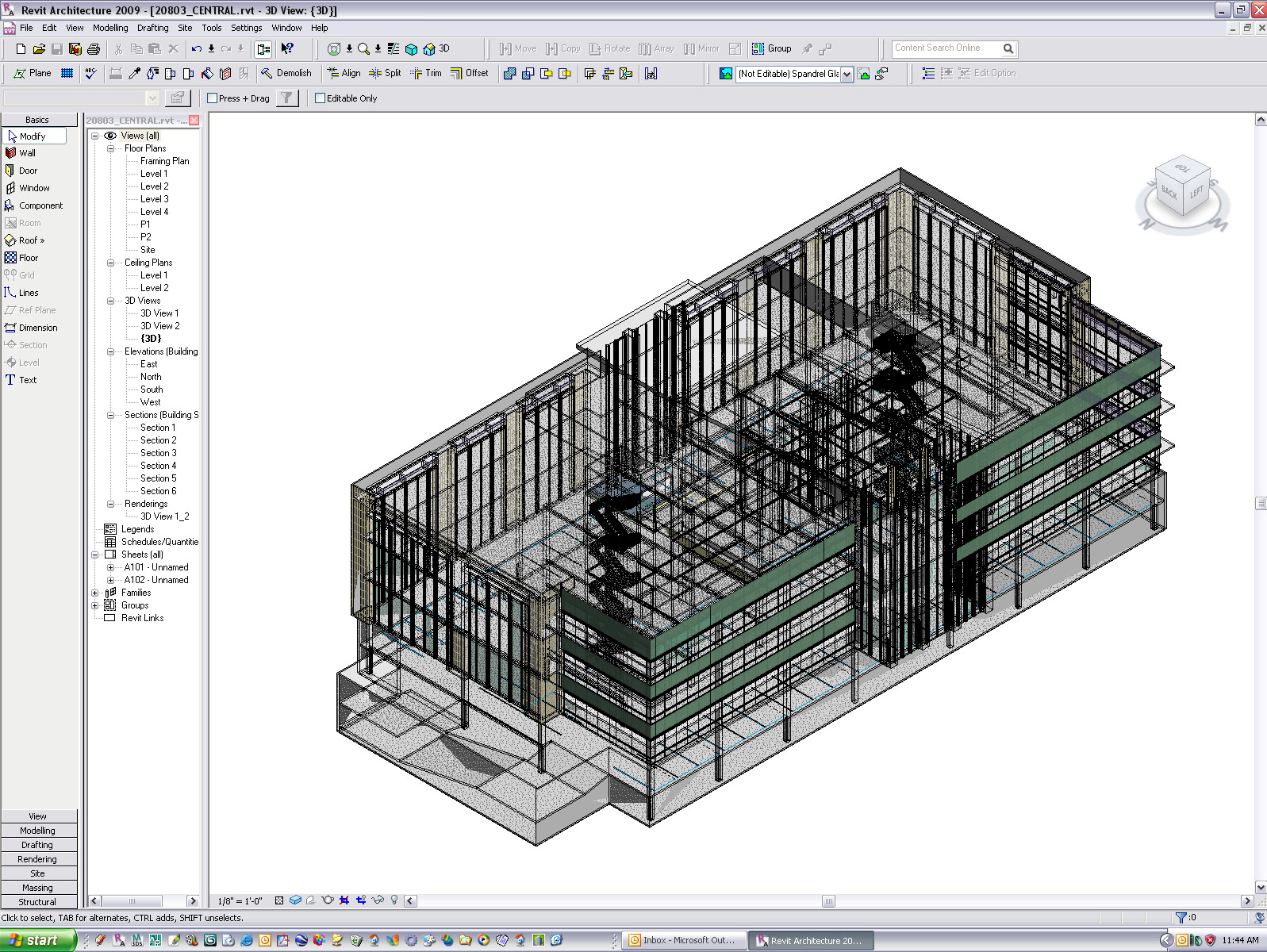

My company has just recently jumped into Revit 2009.  I hid a section of glazing.  When I when to unhide it, the building ceased to display correctly; as if the model were a mix of hidden line, wireframe and shaded-edge.  If did this a couple of times, but if I closed out and re-entered Revit the problem corrected itself.  Now the problem persists.  The model still displays correctly in elevation, section, plan and 3D Views.  Does anyone know what the problem is?  The attached jpg shows how the model is displaying.  Thanks for your help...

You forgot attach the image...

Not sure the image did attach the first time.  Here you go.

Hi, go to the "Options" and uncheck "OPEN-GL", restart Revit and try...

Unfortunately, I have been running with Open-GL disabled.

I started the model with Open-GL disabled.  I tried it with it active before, but it didn't help.  I currently have it inactive (unchecked).  Thanks for your continued help.

When you put OPEN_GL inactive you restart Revit? if so, what carecteristics of your machine?

in roof you have a flat element, pick them, with the right button select "Override Graphics in view -  By element" and check if it's "Transparent"...

 Thanks for your assistance.  As far as we can tell it is a glitch with the ViewCube.  If you click on the top view, then on the Home button the model regenerates immediately.  We tried it several times with the same result.  No other combinations of view minipulation seemed to work.  Truth be told, our AutoCad manager with little Revit background figured it out.  A fact, he was all to happy to point out.
