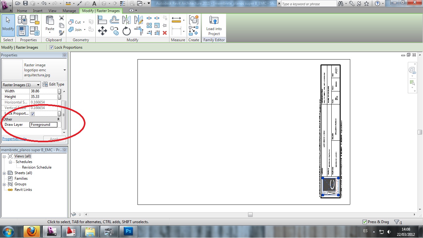

Hello, i had the same problem, i fixed:
In the images properties while editing titleblock, in "Draw Layer" chose "Foreground".
