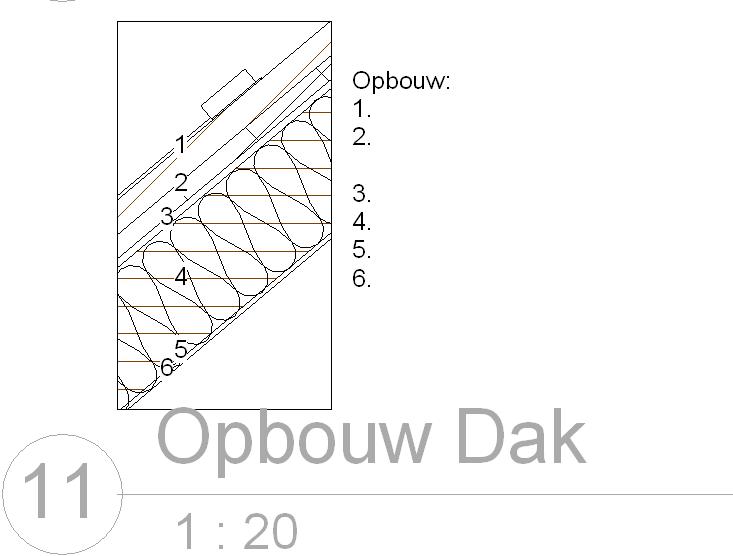

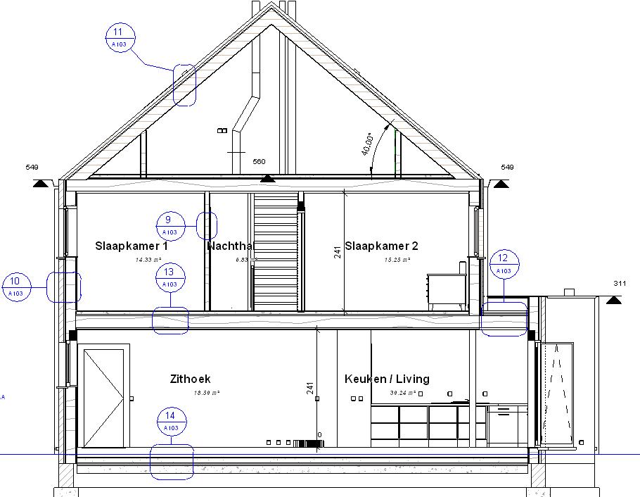

Thanks for your reply, but how do I make these call outs (with extra 2D detailling) visible in the section view of the building? I've put an example in the attachment, it's a section view (with call outs on) and one call out (number 11 of the roof with more detail on (in this example the insulation)), as you see the insulation is visible in the call out view but not visible in the section view. How can I fix this?

First, you need to understand that annotations including text, dimensions, tags, detail elements and edit profiles are all 2D elements and as such are view specific.  Model elements are 3D and therefore will show in all views they are contained in.
When you add 2D elements to any view, they do relate to the 3D components they are annotating.  Therefore, you can copy the 2D elements to your clipboard from a view or callout and then paste them in the same place in the parent view or in the call-out view if you are going in the other direction.
This is a great feature so learn to use it.  One great use is for transferring grid dimensions from plan to plan.  Also room / door / window tags.  Just window the whole view and filter for the annotation you want to transfer - copy to clip board and paste current view.
