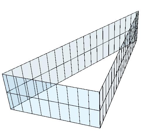

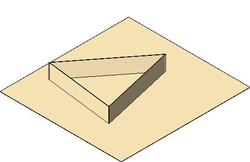

HI,
Can anyone guide me on the issue below ?
When I use Revit at shading mode I can see model colors but when I use Revit at rendering mode I cant see model colors ( model colors are gray-colored ) ?
 See attached
Thanx in advance

Ever Material in Revit has a shaded appearance and a render appearance.  If you don't have a rendering appearance assigned to your material it will render grey...

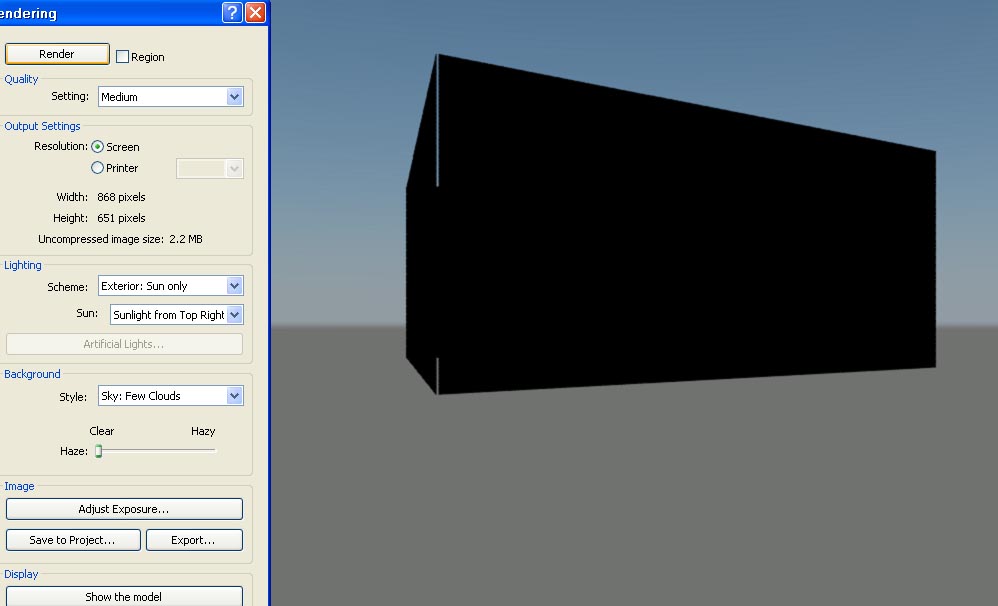

Why when I rendering curtain wall  ( colors are black-colored )
 see attached

Hi, it's seems like you render with "Artificial lights only", in Rendering settings do choose "Sun only"?

HI again,
Still suffers problems...
see attached

Did you turn on your daylight portals?

 Excuse me What do you mean ... I did not understand
