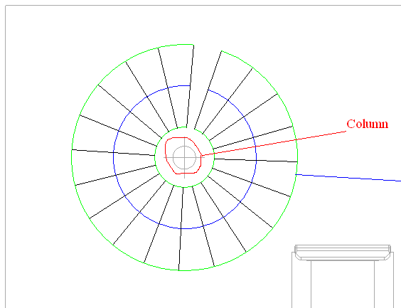

I am working in Revit Arch. 2009 & I want to create a stair adjoining to the column, but after lot of efforts i am not able to join the stair with column sometimes it gives me error that the radius is too short can nybody plss guide me for the same i am attaching an image for ur guidanceThanks in Advance

i dont think there is a way to join the two elements... basically when you create a spiral stair the fist point you clik is the centre and then the next point is the distance to the central run of the stair... so when i do the same as you i work out the distance from the centre to the radius of the column, then the point to the central run of the stair deduct half the stairs width - that's it you want the inside edge of the stair to meet the outer edge of the column - hope that makes sense...
