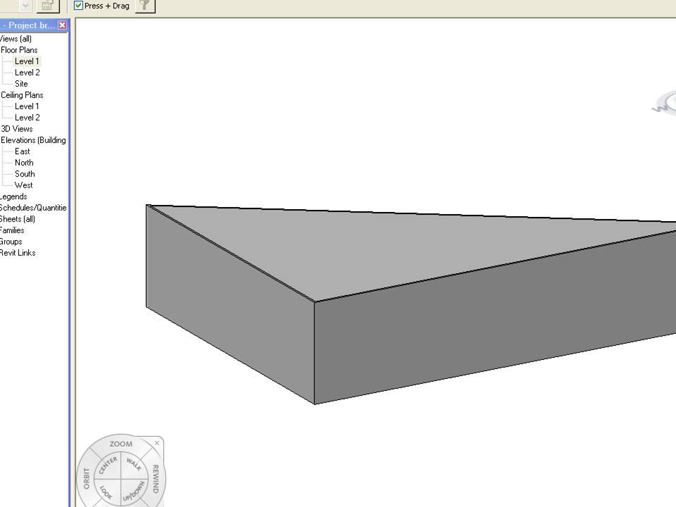

Hope someone in the forum can assist me in finding solving this problem >>> Attached pic

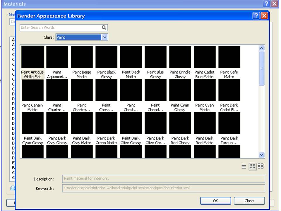

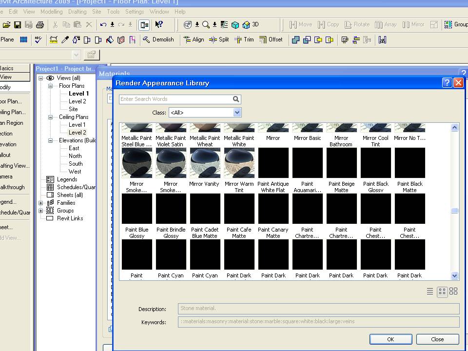

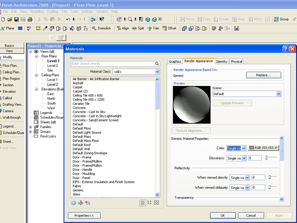

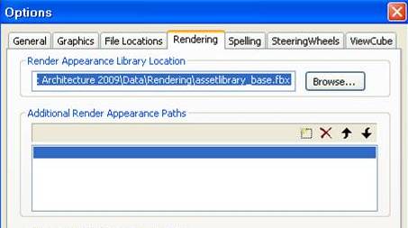

I can see you are using a different material pallete. Is this a new problem? Try to repath your material to the default path (...\Data\Renderingg\assetlibrary_base.fbx) and see if you have the same problem.

I applied these instructions but did not solve the problem, please help .....

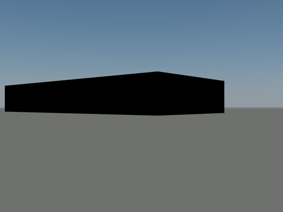

I am still suffering the problem  >>> When I rendering >>> Walls colored black

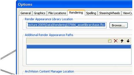

Try uploading the assetlibrary_base I've attached. Don't overwrite your copy. Place it somewhere and repath it.

I am still suffering  the problem...plz hlp

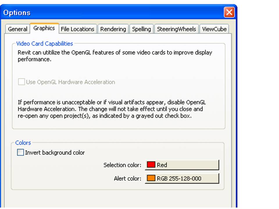

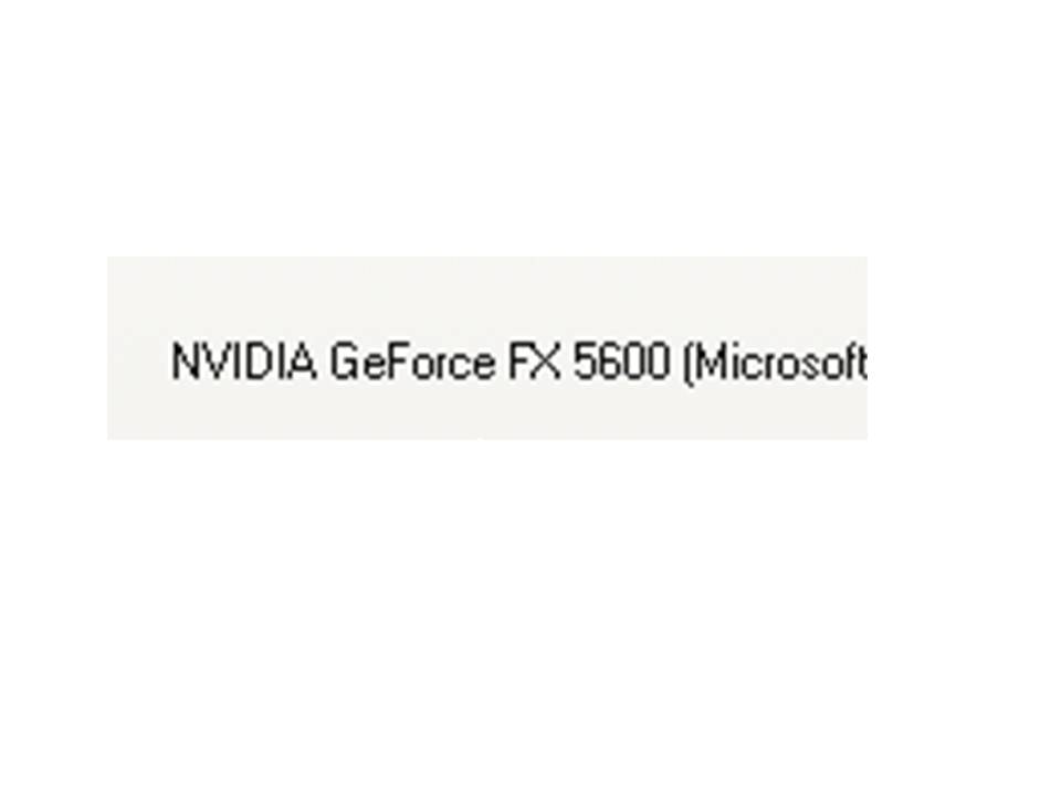

Does your shaded mode appear black also? Check/Uncheck your OpenGL from options, see if that works. What Video Card are you using, does it have the latest driver version?

Does your shaded mode appear black also?  No

Hope you are not using a demo version? You can send to autodesk a file you are working on and they'll get back to you. I can't seem to find the errors. I have mine working ok.

I've been using demo version .... I wish assistance pleaseeee

If you are using a demo version, it seems your download is incomplete. While reinstalling, you still have to be hooked-up to the internet to download all the libraries. The first time you open the program, that's the time it will redirect you to all the libraries required.
