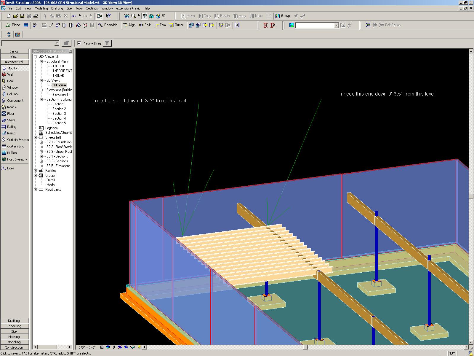

How is the world do i create a beam system at a slope?  Looking in help it says i have to have to pick supports.  I dont have any supports that are running that direction.  I am trying to run joist perpendicular from a glb to a bearing wall that extends past my plane for a paraphet.  Make sense?  It would be nice if you could create a beam system that allows you specify the end offsets.
 See attached Jpeg

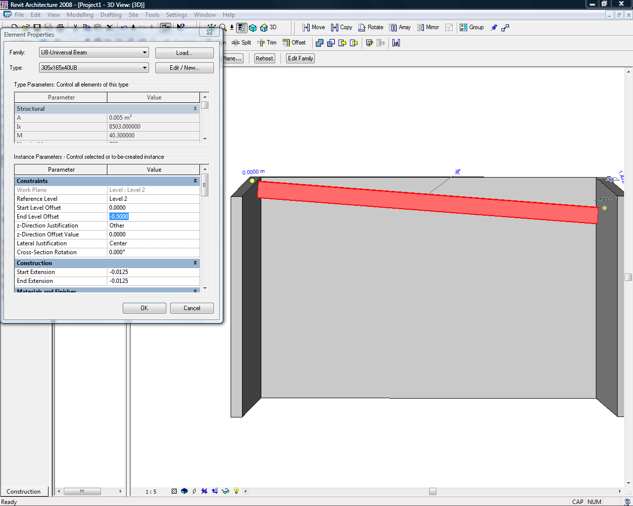

Hi the "beams" have (depend how to create the family) the "chance to modify the "Z" in the 2 Vertices or adjust "By Host" to the element was "insert", so pick the beam, properties and "play" with "start attachment and end attachment elevation and level"...

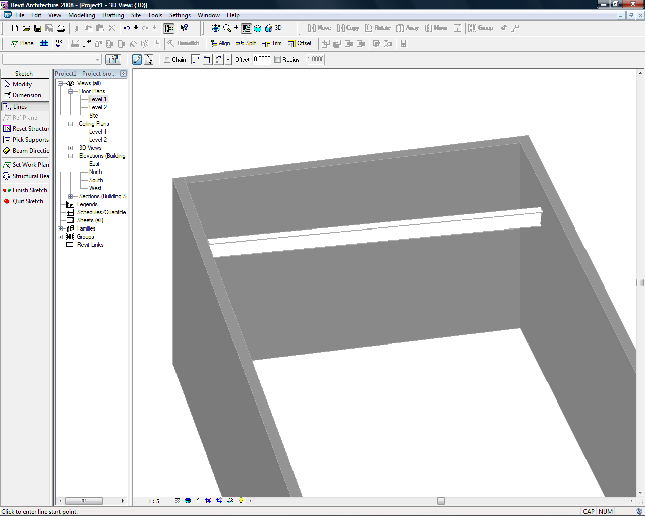

the beam systems dont have a start and end conditions that i can see.  I can see it on beams but not on beam systems.

Hi, it's true but after create the system you can change them...
