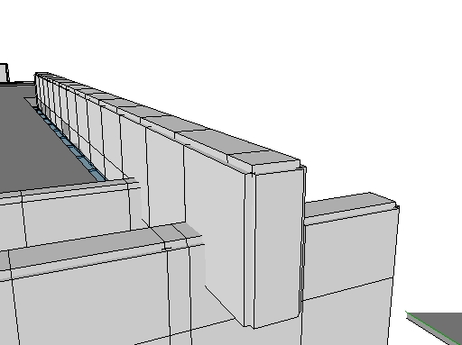

I am doing Richard Meier's Rachofsky House for a class I'm taking. Richard Meier always uses metal paneling for the outside of his buildings. When I do a curtain system with solid paneling the panels don't overlap and there are gaps. I uploaded a picture so you can see what I mean. Also I could not figure out how to adjust the thickness of the paneling. Any help would be greatly appreciated. Thank you.

I think your problem may be caused by the offset setting of your panel.  Play with that and see what happens.
