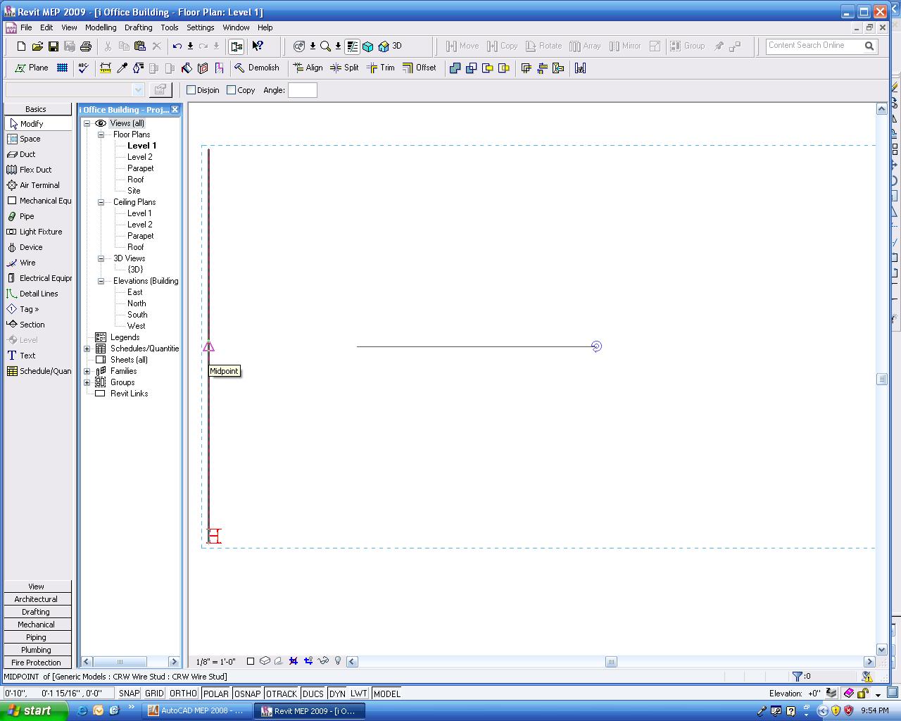

I am creating a type of column family which I would like beable to rotate ninety degrees after it is loaded into the project. For some reason the rotation box that appears is much larger than the family, and the center of rotation is quite a ways off from the family. I realize I can adjust this inside the project, but I would really like to fix it in the family if possible. I want it to rotate about its center.
 Thanks,
MB

check if there isnt anything drawn at a distance in your familie file,
and to control the center of a familie object you can draw a big square or circle around it with its center the center you want, and then make it invisible,
hope it of any help,
