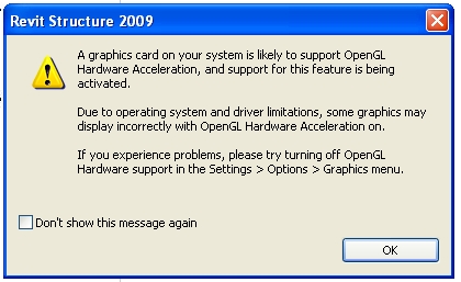

Dear All,
Does this dialogue indicate there is something wrong or incompatible with my video card or Revit Structure 9

If you see there is something wrong when you work in revit, you must turn off OpenGL, this is only an advise...

if your model is "disappearing" or getting clipped in 3-d views then turn this off.  If your computer supports opengl then use it for sure.

If I see something wrong with revit, how do I turn off openGL?

In OPTIONS > GRAPHICS > HARDWARE ACCELERATION
