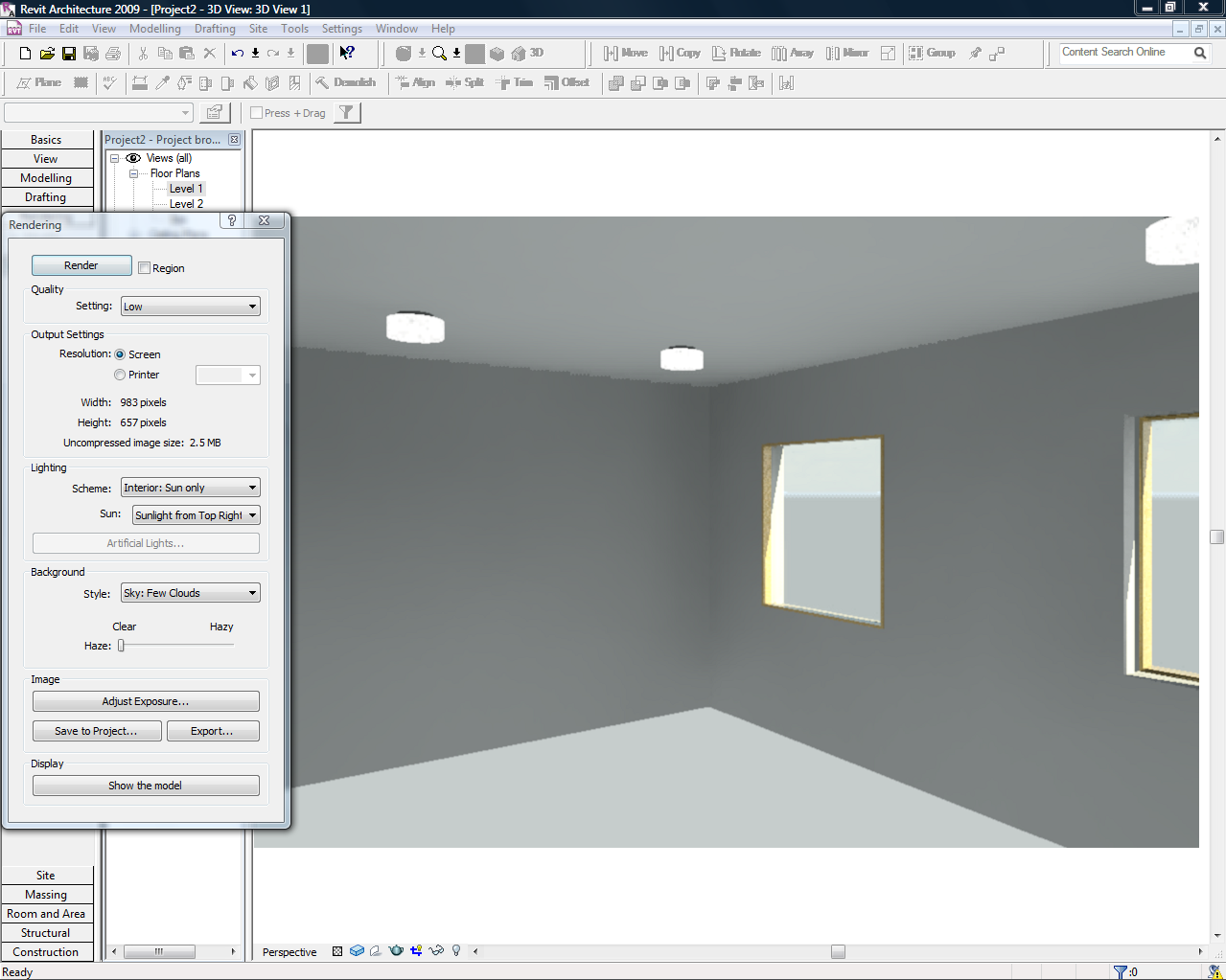

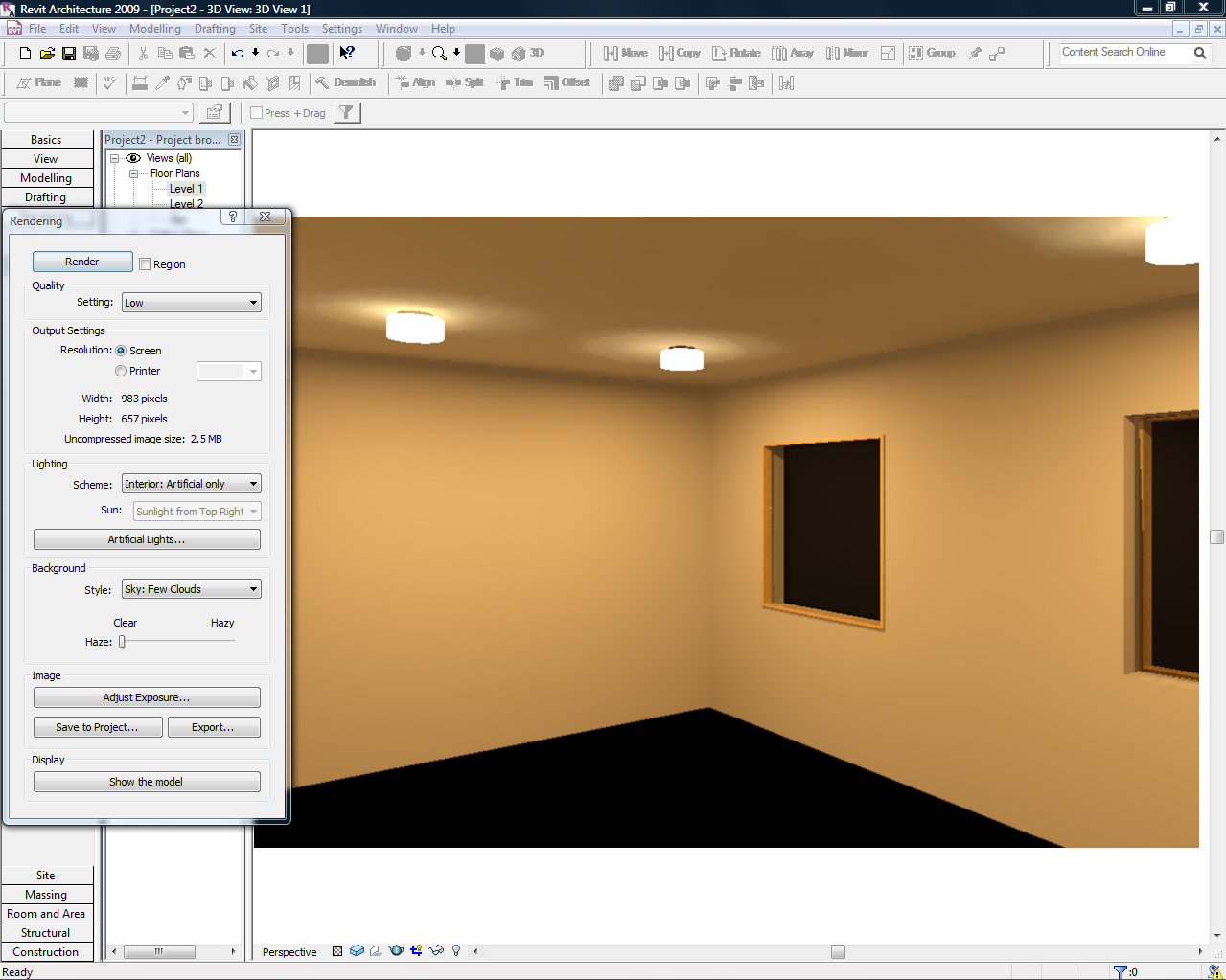

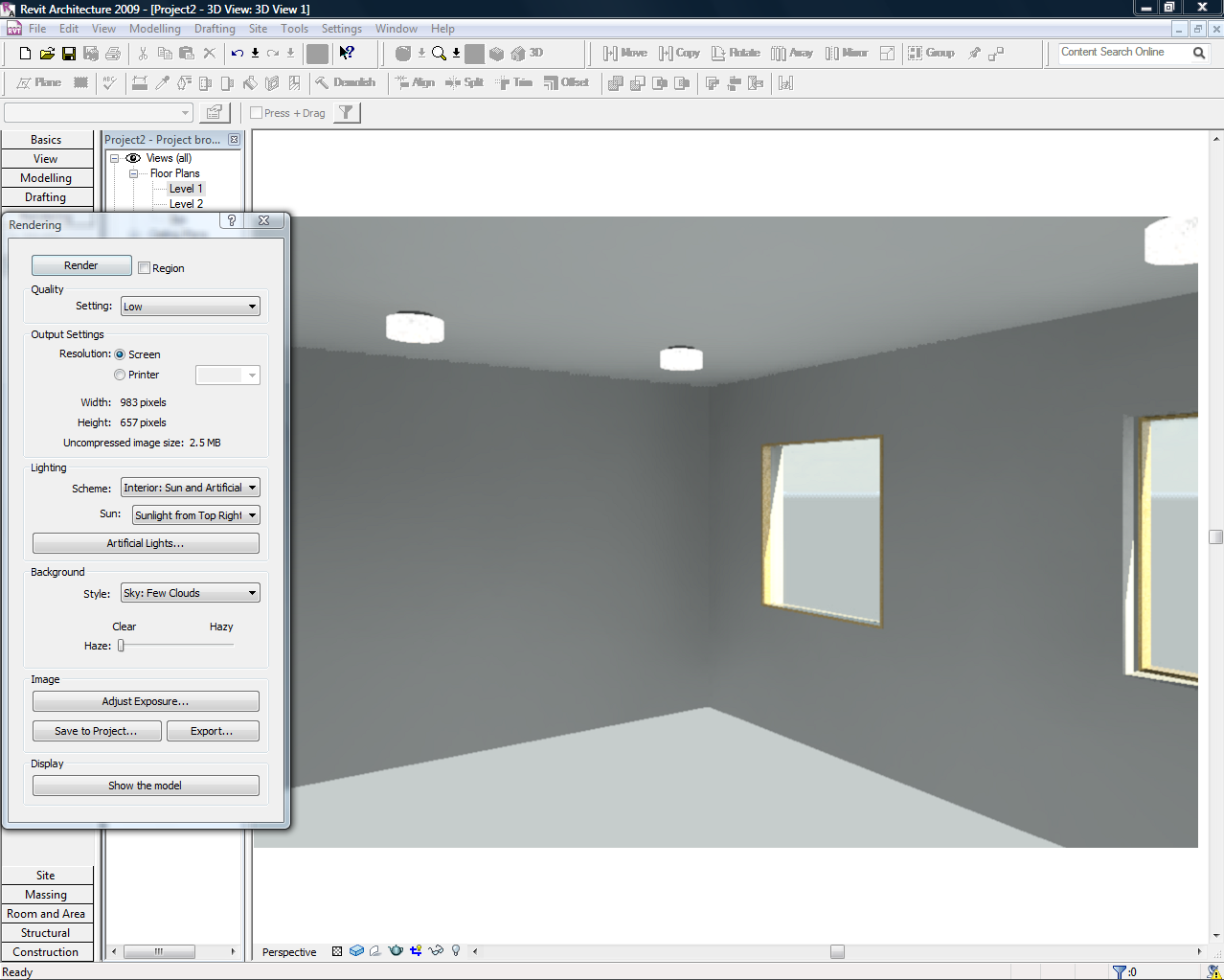

Hi, i try with the 3 option and you can see in image attach, this work fine, when you use "Sun Only" you don't have the choise to turn off the interior light, i don't no if it's a "bug" but..., see also (after do what "BDerrick" says) what kind of light do you have in your model, select one of them and go properties and check the values of watts, lumens and so one...
