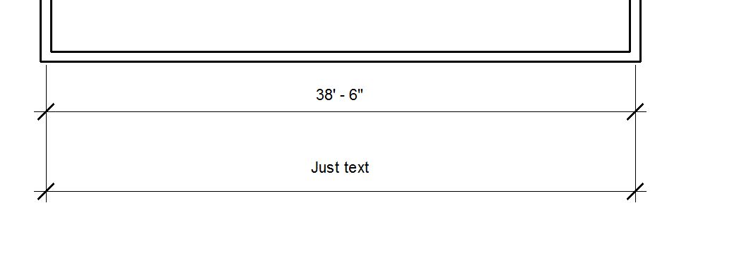

Sorry to disagree, but I just went back to doublecheck and I can make dimensions in 2009 be replaced with text.  But perhaps I am misunderstanding.  What it does NOT allow you to do is to put a numerical value in the override box.  That was a good idea, as you get the best of both worlds....no lying about dimensions, but you can change a dimension to something like"varies".  See image.

LIZAR was right, we can change the value by "Replace with text", sorry LIZAR...
