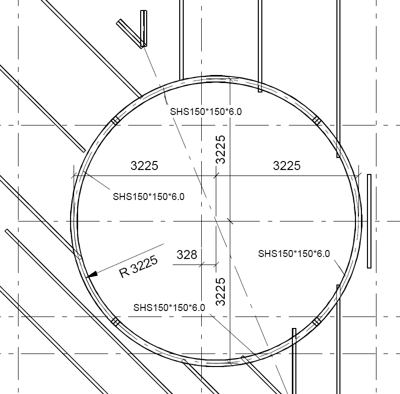

HI,
Can anyone help me in placing a circular beam?
Find attached snapshot for required shape.
Thnx in advance..

Wed, May 14, 2008 at 11:51:52 AM | Circular Beam
Looks like you already have it placed.... or are you really asking something else?
Thu, May 15, 2008 at 2:41:19 AM | Circular Beam
Rams
Joined: Fri, Mar 28, 2008
128 Posts
3 Stars: 3 Votes
The snapshot is taken from the pdf file. I have to put into my structural model. There is one option of putting beam on grid but its not taking circular grid

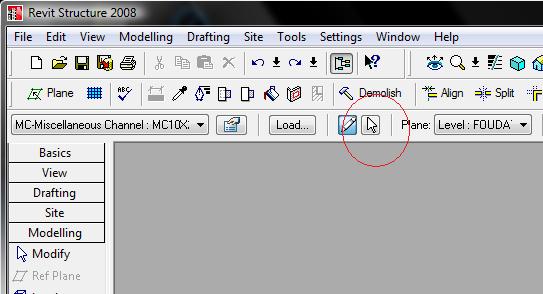

Ok..so let me get this straight..this is what you want?

Thu, May 15, 2008 at 9:09:21 AM | Circular Beam
jmsfuentes
Joined: Wed, May 14, 2008
13 Posts
ok..its pretty simple. when you select the beam button under modelling...just select the arrow button on top. the "pick lines" button. Then it will follow whatever shape you select.

Thu, May 15, 2008 at 9:15:30 AM | Circular Beam
#9
Rams
128 Posts
3 Stars: 3 Votes
Nope. I am getting beam button under structural tab and it doesnot allow me any pick button.

Thu, May 15, 2008 at 9:22:58 AM | Circular Beam
#10
jmsfuentes
13 Posts
sorry..just realized you where using building and i am using structure. so you dont have this option up here??
Thu, May 15, 2008 at 9:29:58 AM | Circular Beam
#11
Rams
128 Posts
3 Stars: 3 Votes
Ya i am using revit architecture so not getting this option.

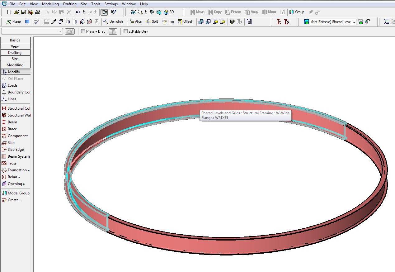

Thu, May 15, 2008 at 9:43:05 AM | Circular Beam
#12
jmsfuentes
13 Posts
Sorry..cant help you with building. But here is another way to work around it. If you have revit structure. You can do the beam there...import the structural model into your model, then do a copy monitor on it and then just remove the link. just a thought.
Thu, May 15, 2008 at 9:44:17 AM | Circular Beam
#13
JHanby
Joined: Thu, May 25, 2006
177 Posts
3.5 Stars: 3 Votes
Revit 9.1 doesn't have it.
Thu, May 15, 2008 at 12:40:23 PM | Circular Beam
#14
lunchtrayrider
Joined: Sun, Jun 24, 2007
592 Posts
3.5 Stars: 7 Votes
do an in-place family and categorize it as structural framing.  Unless you have revit structure.
