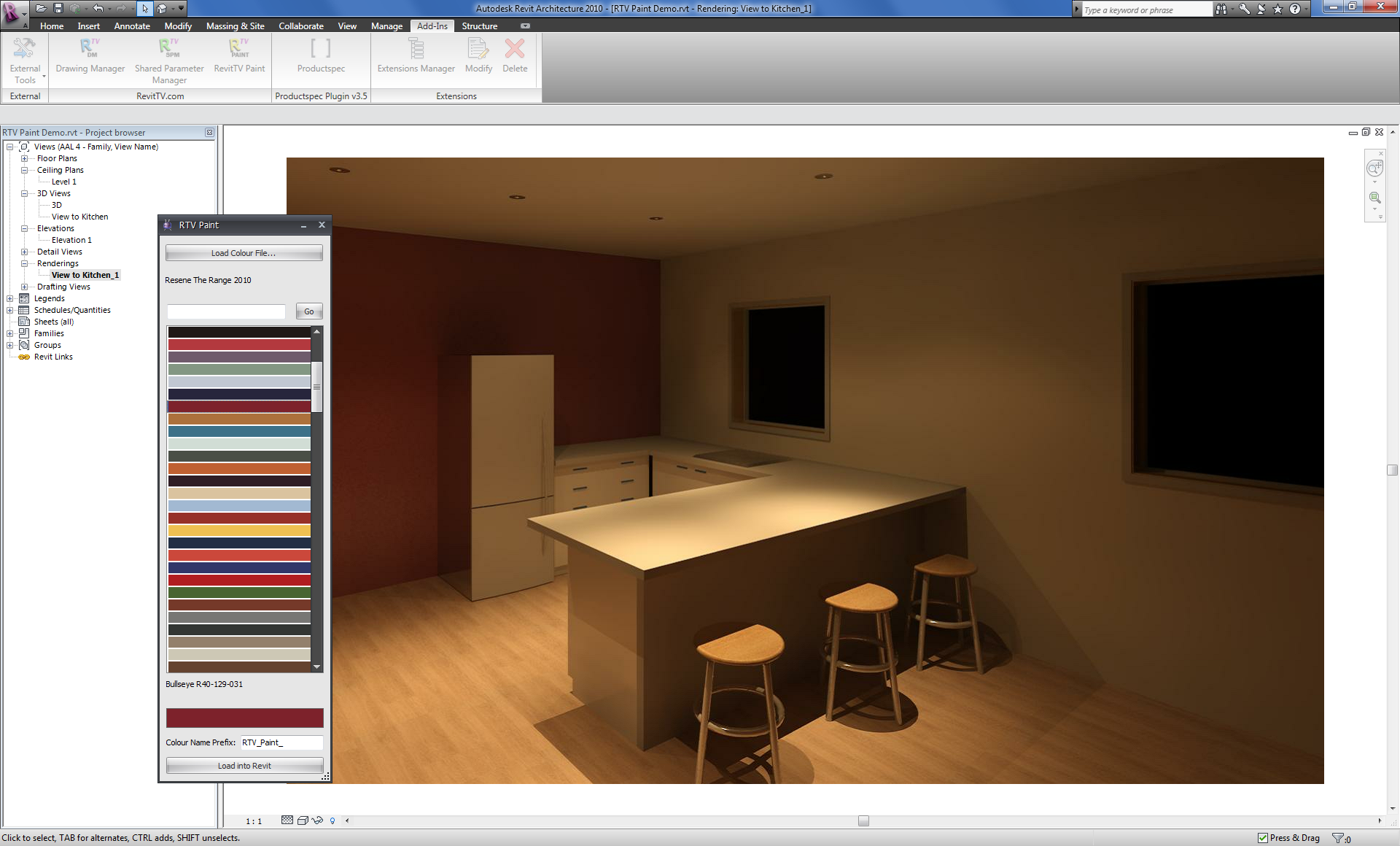

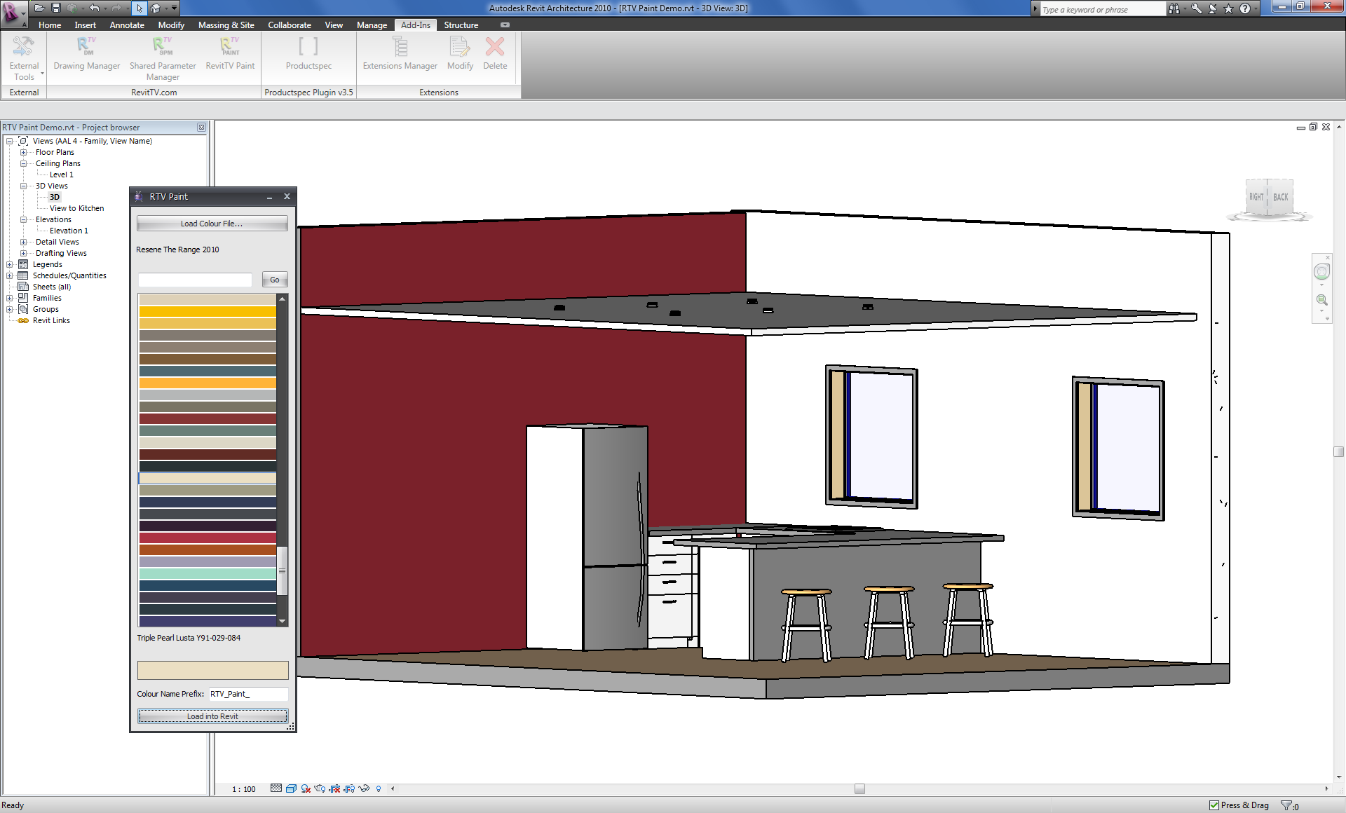

You should give the newly released "RTV Paint" plug-in for Autodesk Revit a go...
With RTV Paint you can import Autocad Color Book files and then use the plug-in to automatically create these colors as Revit Paint Materials, which can then be used with the Paint tool in Revit for shaded and 3D rendered views and elevations etc.
For more information please refer to the below websites:
http://www.tenlinks.com/news/PR/revit_tv/011910_rtv_paint.htm
http://revittv.com/
