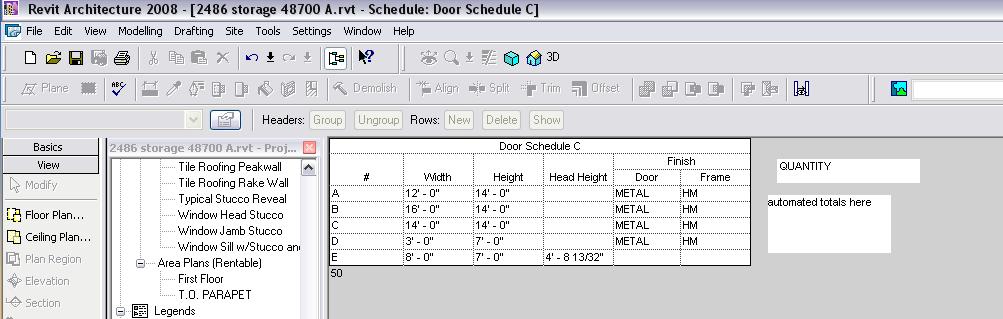

Is there a way to make Revit 2008 automate the total quantity for each door type in a door schedule instead of a grand total? I know I can create a new field and enter the quantity manually but I want to avoid this.
Thanks!

I think what you are looking for is the count parameter that you add to the schedule. In order to get this to work properly you have to add the field COUNT. Then go over to the Sorting/Grouping tab and sort by what you want. I like to sort by family. Make sure you uncheck the itemize every instance check box at the bottom of the sorting/grouping dialog. Then go over to the formatting tab and select count and check the box for calculate totals.
HTH

Thanks that did it! =)
