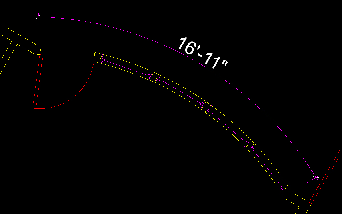

See attached image. How do I get Revit to do this??

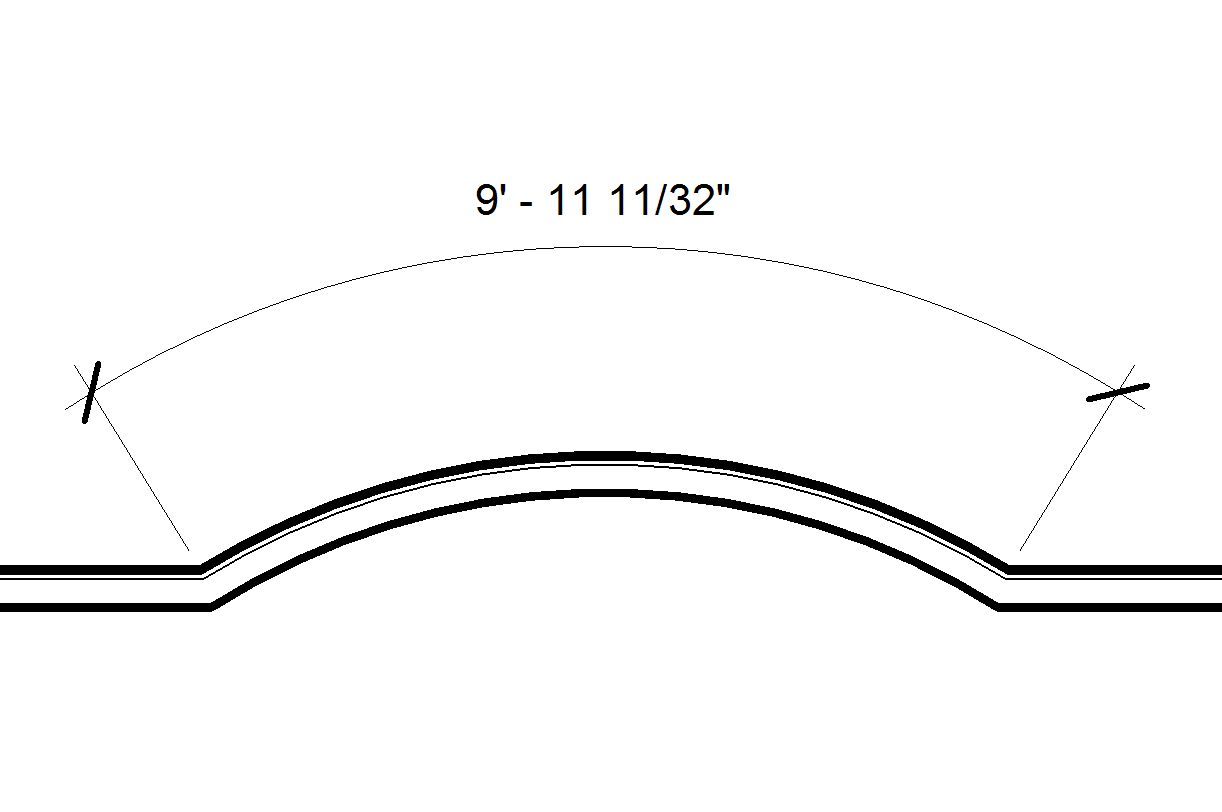

Select Dimension from the Design Bar, then on the Options Bar, select the Arc Length button (should be the last button before the word "Prefer:" ).  Now select the wall arc you want to measure, then the from point, to point and finally the location of the dimension.  NOTE:  you may have to use the TAB key to cycle through to the point you want to pick
