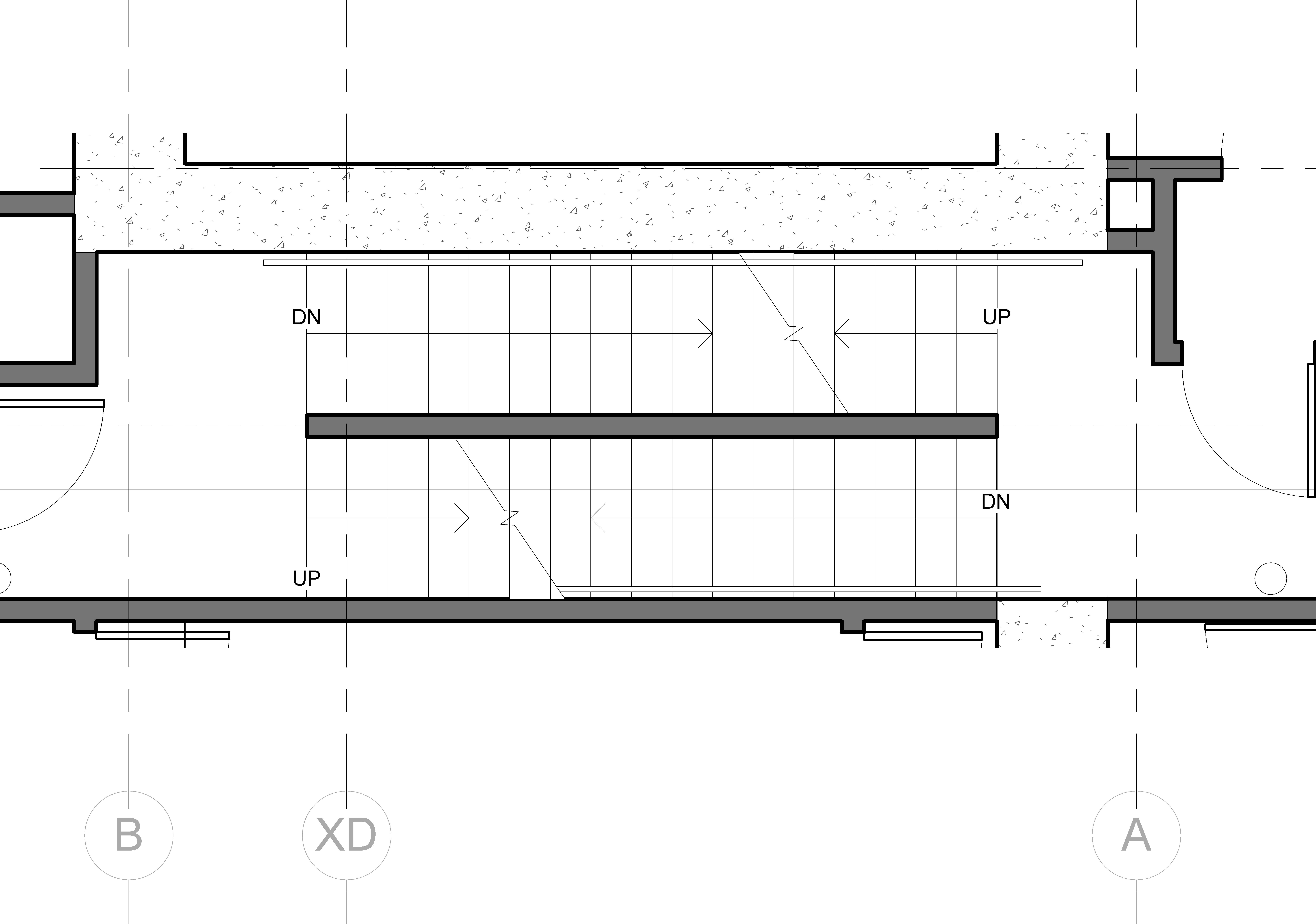

How do you adjust the length of the stair UP / DN arrow? I need to make my DN arrow shorter (see attached). Thank you
Mon, Apr 21, 2008 at 2:25:41 PM | stair UP / DN arrow
I would edit the down stairs and turn off the arrow... add your own if req'd.

I was afraid that is what I would hear. Thanks.

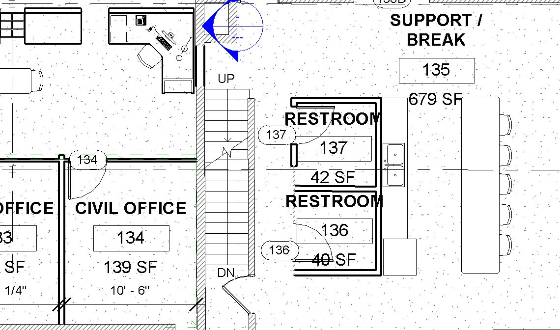

I had the same problem....but if your cut plane for the view is 4' or less....it seems to work.
