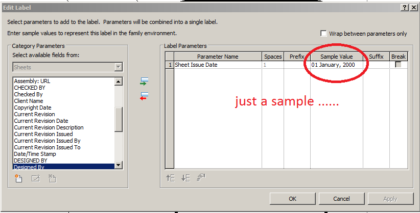

Hi, I'm trying to set my sheet issue date to read DD-MM-YY instead of the default format MM/DD/YY without having to manually change each sheet. Is this possible in Revit 7? Thanks.

Regional Settings will change this on your computer. Check out the Help and Support from the start menu and search for "Regional Settings" This will enable you to change the standard display form. Hope it helps.

Hi, does anyone know if this got fixed? I checked my computer and its date format is fine dd/mm/yr but Revit is still writing it as mm/dd/yr.
Tue, Apr 15, 2014 at 7:21:31 AM | Sheet Issue Date Format
I believe this and project issue are both supplied by you... not automatic.  Enter them however you want.  The default that shows up initially can be edited in your sheet family.
