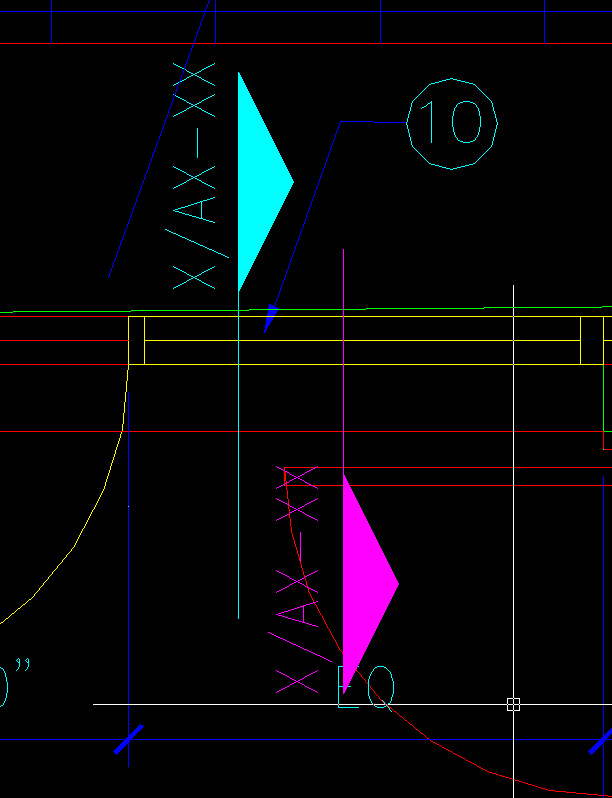

main question: is there a way that you can lock text to an object, so when you move an object, text associated with the object also moves?
 what I would really like to do is create a section marker where the text will rotate so it always has the same relationship to the section head.  (see attached picture.)  I'm having difficulty with this, as it seems that revit wants to make all the labels in my section head family rotate automatically in my project so they are perpindicular to the section cut, whereas I would like them to stay parallel.  any suggestions?  I was thinking if there were some way I could "lock" the labels to the reference plane for the section line so they would rotate together, I could make this work.

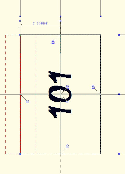

I think this one has it in there... this is the door tag that we use, we can create types to match angles with our doors... and allows italic or not indicating fire rated door or not...

How do you create all constraints between the reference lines in the group (refer to attached image)? I've tried to re-create the tag you have posted but I'm not able to get padlocks in all the positions you have.

typically i just use the align tool, then lock it.  can also use the pick tool to draw the line and ceck the constrain box on the options bar.  hope this helps.
